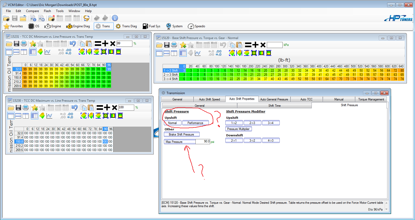

Many of you are bored with my slow progress, but I finished my 80e swap in my 02 Yukon with a 5.3.
Can someone review my tune to see if I've got the 80e dialed in OK? The trans is internally dual fed and thats all the mods done.
I did my best and think I set my shift times to 0, and removed tq management.
Thanks!

Not much to trans tuning
0 tq mgt
0 shift times
Approx 10% over base pressure with max line pressure at max torque input
Tcc pwm 99 min 100 max

This stuff?
That 90psi should be 99?
Upshift (norm, perf) are the ones to mod?
