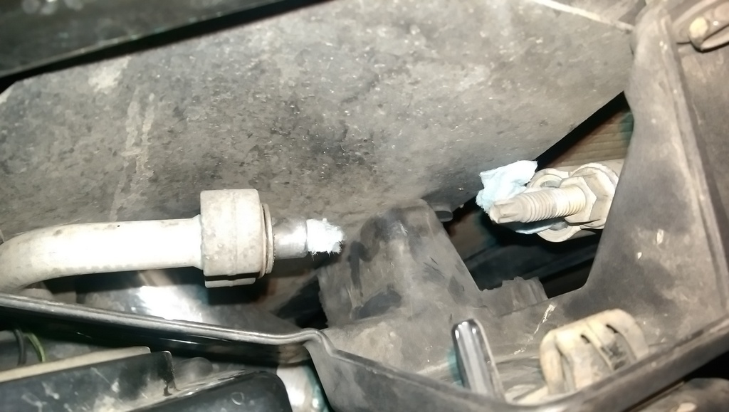

Here's a picture for anybody curious what I mean about needing to extend the AC line... As you can see, the charge pipe pushes the line away from the condenser. All I do is go to a junk yard with junk that isn't rusted/corroded, find a wrecked truck, and cut those blocks off the condenser and refrigerant line with some extra length on them. Then flip them around, trim the line as necessary, and TIG them together. Then you just drop it in and charge your AC.
