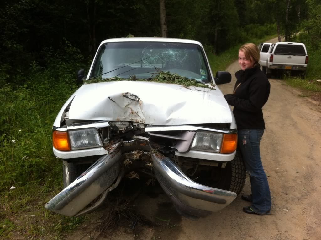

Carnage pic.
The "maybe" truck. 1999 ford ranger - not running

She try some Travis Pastrana moves in the woods Wikipedia says they gave it more power in '00 (part changes), so you might be fine.
Edit-said they went distributorless in '96, long block might be the same though.

Well, cut the hood off today, and found out that her truck has a 4.0.......
Looking for plan B now.

Had a buddy from a frame/body shop come over and take a look at it, just in case the frame horns could be straightened. He showed me where the left frame horn buckled, where the cab buckled causing the doors to bind up on the hinges & latches, and where the right frame rail is bent behind the cab. Also, the right side of the cab had slid forward over an inch on the frame, and there's a BIG gap between the cab and bed now.
Looking for another Ranger or Explorer with a blown engine, to put her engine into. She's a full time college student with a part time job, and money's tight.
