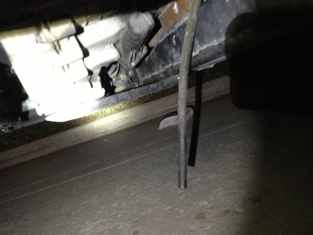

Driving down the road just now, my truck turned off and the battery light came on. Coasted it into a parking lot. It would turn over but not start. I see this hose hanging down under the truck and don't know what it is. Fuel return line? I don't see where it connects so guessing that part off the hose fell off.
Need help guys

Hose is probably 3/4" OD and 1/4" ID. Doesn't really smell like anything and doesn't have an oily residue
Line looks like it runs from the engine bay to the back of the truck. Got disconnected right next to the transfer case.

Looks like the transmission vent line
Would that cause my truck to stall? I'm guessing no, so second question is what else could cause my truck to die like that? Has a half a tank of gas in it.

I agree thats the transmission vent hose and I think its unreleated to the current issue.
What fuel pump are you running? I'd favor a fuel pump issue at this point.

The is absolutely the trans vent line. You dying problem is probably fuel pump going out. It could be a million other things. Too late now but you should have checked for pressure at the rail when you were a sitting duck.
