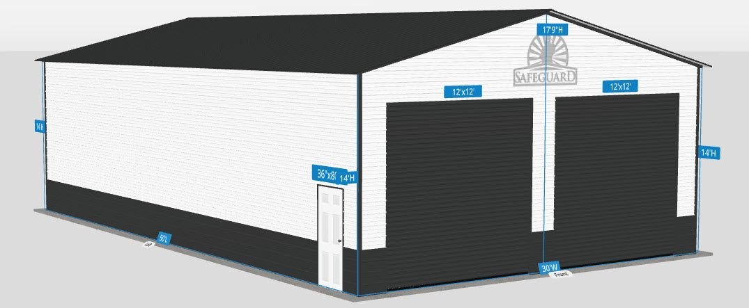

I don't know anything about concrete, but have a project coming up soon. Is the below specs enough for a 30x50 steel building? Am i getting ripped off at $7 a square foot that I was quoted?
4" Slab
8" beam around the outside edge + one down the center
#3 rebar 16" on center
3500psi concrete
moisture barrier
10,500

the best quote that I received before this one was 13,500. The company that I bought the steel building from recommended him for the concrete work. it was all a very spur of the moment purchase. I stopped by a metal structure place on the side of the highway to look at a carport and they were wrapping up a memorial day sale that expired yesterday. I spent a lot of money not expecting to spend.
30x50 with 14' walls and a 3/12 pitched roof. I upgraded the frame from 14 to 12 gauge, and the walls from 29 to 26 Gauge. 2 12x12 electric roll up doors and a few other little details. I'm hoping closed cell foam is in the budget along with A/C and lifts.
