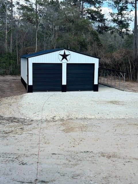

the pad is done. 30'x50'x6" with 12" peremeter and around 10" poured for the first 16' of my left bay. I've already blown through the budget i set for myself. the thicker concrete was an extra 1.50 per sqft and i decided to add a 12x50 lean to which required a 12x12 beam to be laid for the legs to sit on. 20 loads of dirt had to be brought in at 150 per load. I'm $10,500 over budget and haven't even got to the electrical.
4-6 weeks lead time for the materials & building erection.

still needs electricity. I ended up adding a 12x50 lean-to. The slab is 6" with #4 rebar and the first 16' of the left bay was poured at 8" with 3500 psi slab.

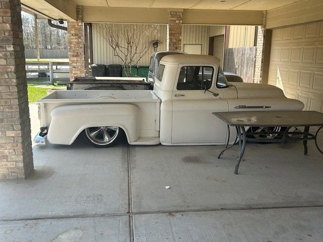

Here is a sneak peak at the newest shop project. 1956 with A/C, heat and sniper EFI on a cammed SBC. Just a cruiser but i have an extra heads/cam/blown 6.0 laying around along with a spare 80e. Not sure if i care to hop it up though. The chassis and drivetrain is already built for the power if i decided to add some power. Don't know if i care to mess with it though. If i want to go fast or hit hard corners i can hop into the 69 Camaro or the WS6 trans-am. it looks good and sounds good. who cares about going fast anymore lol. I'm super happy to have a cool truck back into the fleet. The f-bodies are fun, and have become good investments but I'm a truck guy at heart. It's been a long time since I've had a cool truck and not just work horses.
