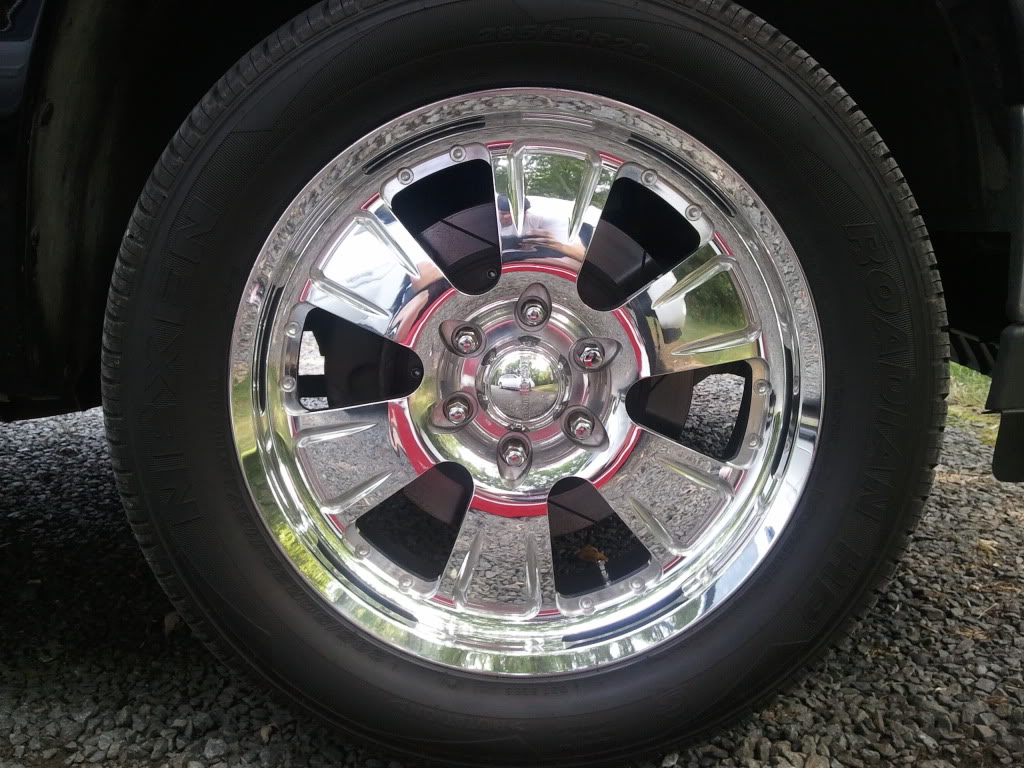

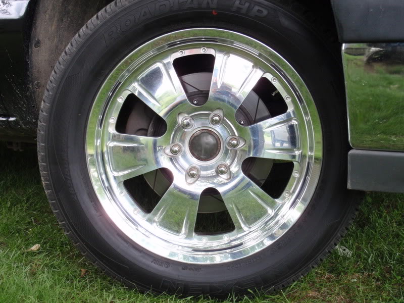

I used Adams metal polish 1 & 2 on my centerlines and they came out looking like fresh chrome!
BEFORE

AFTER

Now that's impressive! Very nice job...

Did it all by hand with the Adams stuff. First cleaned them off with just some warm water and a soft towel. Then used a micro fiber to apply Metal Polish 1 and wiped off with a double soft micro fiber. Did the same process with Metal Polish 2. The wheels usually will look pretty good after that. But to make them POP I use a hex grip applicator and some Briliant Glaze, let it haze, then a double soft to buff it out.
I try doing that twice a year. Any other time I just wash them off with the car shampoo and then wipe them down with detail spray.
The main thing with bare aluminum is to use as soft as a towell as you can. They get hazy quick with cheap micros.
