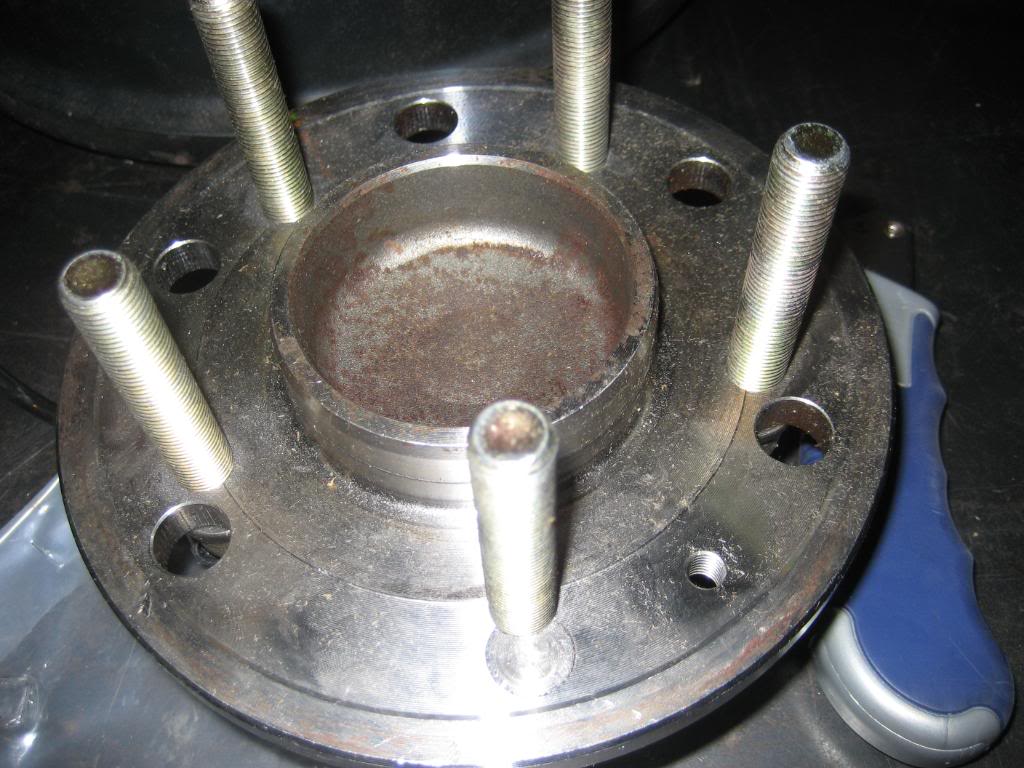

Just got off the phone with Mike the shop foreman at Moser and they WILL NOT do the 5lug conversion on the factory front hubs and rotors anymore. Called them before I sent mine before I spent the $50 it cost to ship them and was assured that it would be no problem. Now it's a problem. Just FYI.

The same reason he told Travis(blown06). They don't have a way to chuck it up in the lathe once its welded so they have to use a hand grinder. Told him I didn't mind paying him whatever to make it happen. Wouldn't do because it wasn't professional enough when it left the shop and he couldn't make enough money on it because he would have to take a guy away from making axles, which they make more money on. Basically, more manual labor than its worth for them, even though I said I'd pay it.
He is going to take care of return shipping though.

I dunno man, this looks pretty professional to me. A lot better than what me and Tyler will come up with LOL

I had a friend who is a professional welder weld mine up, since I didn't trust myself not to warp the crap out of them. I drilled and tapped them myself with a CNC'd wheel spacer as a guide.
