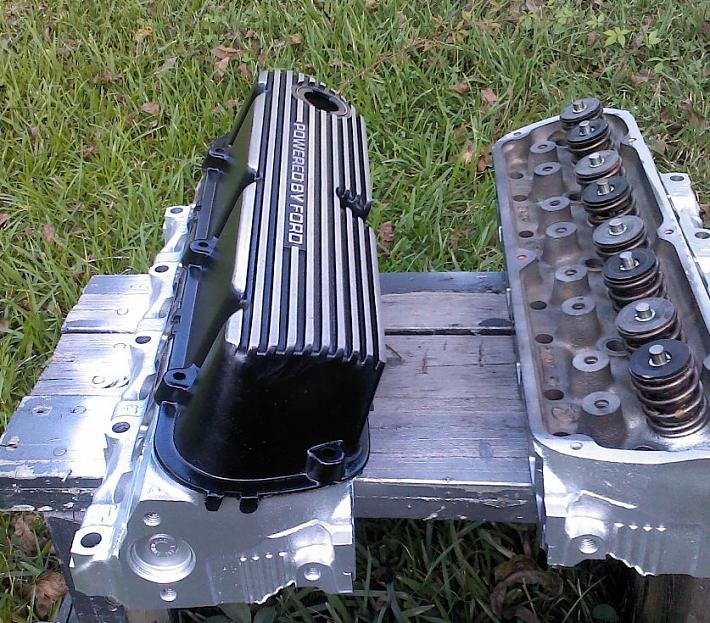

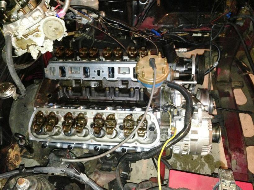

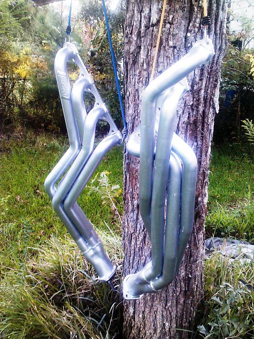

more pics ...
Attached Thumbnails Foxbody Questions-heads.jpg   Foxbody Questions-headers.jpg   Foxbody Questions-rear.jpg   Foxbody Questions-img951056.jpg

Sorry i never updated this thread! I finished the motor build about 3 weeks back. Ended up grabbing some 'slow as hell' stock GT-40p heads and working them at the local head shop (p/p, valve job, mill), slid a custom spec'd Anderson racing cam in, RPM intake, LT headers.. then found a built rear that had an Eaton unit, 31 splined Mosers, and 4.10 gears in the 8.8" housing. I'd be confident to line this stock piece of crap up with that long bed HD
For others that were curious, i know these Fox's are a dime a dozen.. but it made 332 rwhp on the dyno through a 670 Avenger carb with vacuum secondaries and it weighs under 3k lbs. I haven't got to get it to the track yet, but i am pretty confident she'll go low 12's - high 11's.. and the best part, I am still at ~$3200 on the tally for the entire build, including the purchase of the car. I have bought almost everything used except for the cam.
