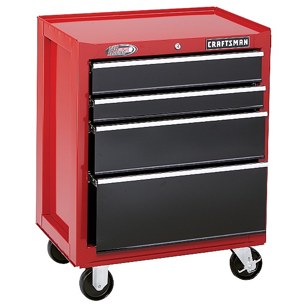

Well i have been wanting a new tool box for awhile now, my old one was wore out and out of space. Sears was having some pretty good sales on thier Ball-Bearing boxes so I went and picked up a couple of them The bottom ones they had on sale were red and black, but i wanted all black,
to match the middle 3 drawer ones i bought. The bottom ones are thier middle grade ball bearing ones with the stiffer case. The middle ones are the griplatch ball bearing ones.. Both have similar slides and are decently sturdy.

This is what the new ones looked like when i bought them.
So i broke out the spray gun and shot a couple coats of gloss black rustoleum. I diluted it with ~50% mineral spirits.. If yall have never shot rustoleum paint dilluted before, it works pretty damn good because it self levels, just remember it is thin so it will run quick. The bottom 2 cabinets were red and black and the 2 top pieces were black.
