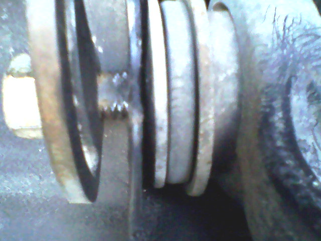

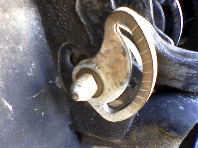

i thought my ball joints were bad so i went to replace them and found this, its the camber adjustment on the upper a-arm. i took the nut off to get a better picture. has this happened to anyone else? what did you do to fix it?

whats the problem with it?
Old Oct 26, 2010 | 04:51 PM
08Chevy's Avatar
Joined: May 2009
Posts: 1,070
From: Athens, Texas
Did you break off that little "nipple" that they use to measure?

the little pin to keep that cam in place broke and fell out, without it, no matter how tight i make that bolt, the upper a-arm will move all over the place
yes sir

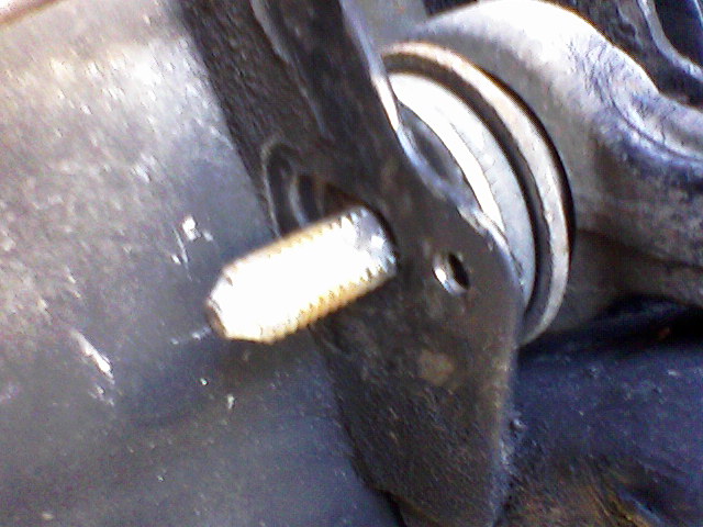

stick a bolt or something in there.

****. I don't know what to tell you. Weld it back. I don't know how to fix **** like that.

i would weld it back but its gone
there is on room on the back side for the head of a bolt
you can see the bracket in the center of the picture, the thin black piece running vertically, the bushing is to the right of it and as you can see, there is no room there for anything to stick out

Put a few small tacks on the cam or weld a new stud in. Both are easier said then done if you don't have a welder! But if that is the case I gotta hope you know someone with welder.
