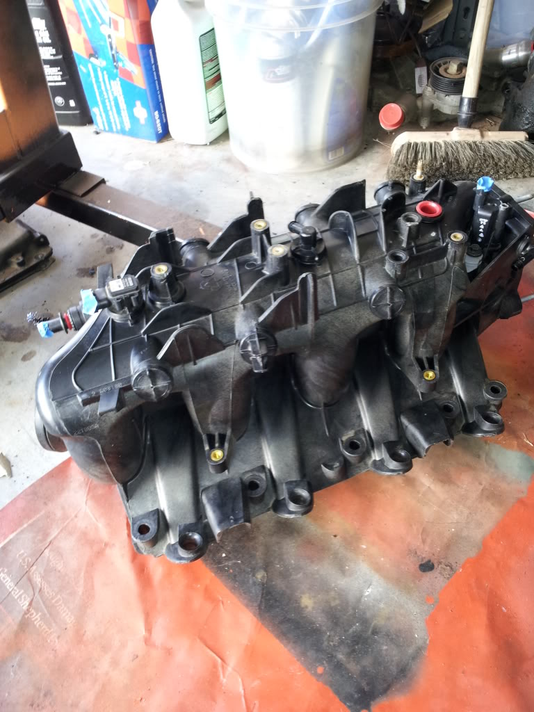

I am going with my own personal spin on my C10 and wanted to ask the TBSS experts here a few questions.
Is this an SS intake?
Will the fuel rail from a 5.3 or '99-00 LQ4 fit along with the injectors?
Old May 31, 2012 | 08:41 AM
TXSZ66AVLANCHE's Avatar
Joined: Sep 2010
Posts: 1,920
Nope, that's not a tbss intake.

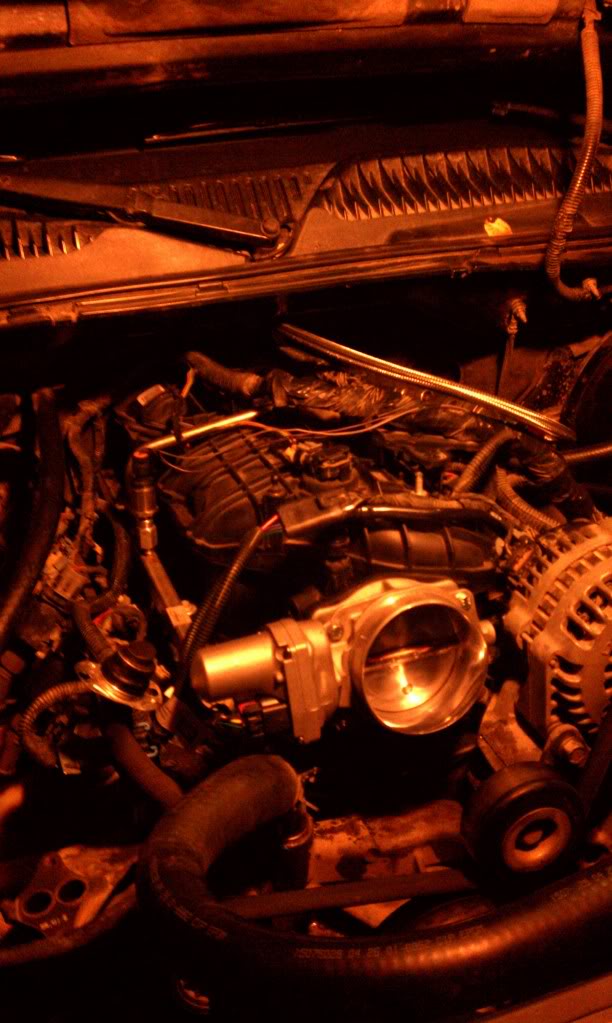

Do you have a pic of what it looks like for the ls2?

This is the only good pic of mine. The tbss has a 4 bolt tb.

The tbss intake will be alot wider up top and have a 4 bolt Tb opening.
Also none of the 3 bolt tb intake fuel rails will fit the tbss intake.

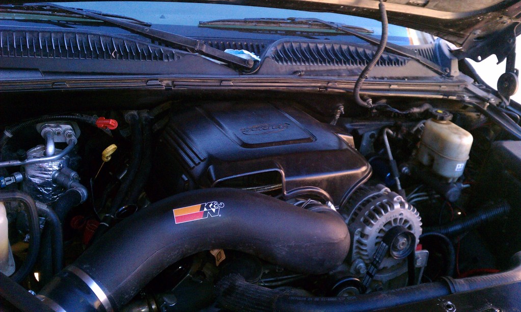

That was awesome brother. Is it possible to mount the TBSS intake cover on a regular truck intake?
Old Jun 4, 2012 | 10:19 AM
AndysC3's Avatar
iTrader: (14)
Joined: Jun 2009
Posts: 2,884
Likes: 10
From: Minot, ND
not really mounted but it stays put
Old Jun 4, 2012 | 06:47 PM
kainedogg's Avatar
iTrader: (23)
Joined: Mar 2006
Posts: 1,108
So whats holding it on?
