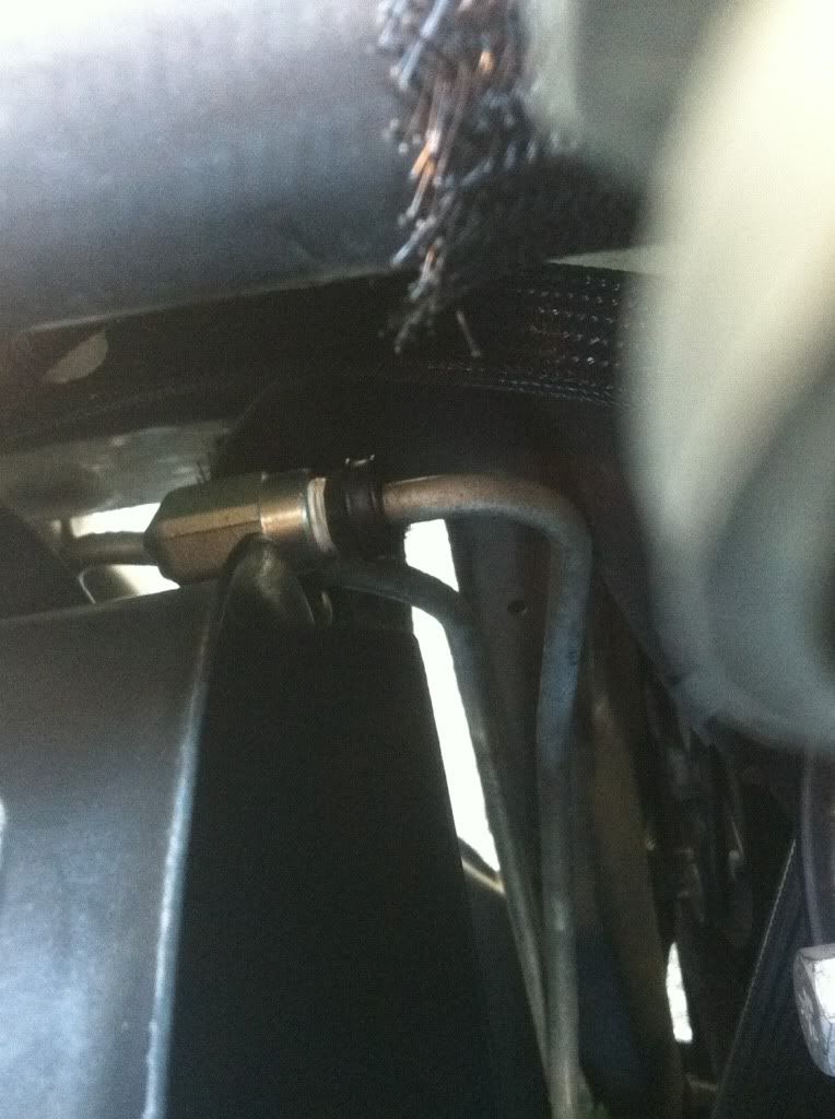

I took my efans off to sell them and put my stock clutch fan back on. Apparently I hit the trans line directly beside the fan shroud.
(The hard line and hose directly below the visible line and hose)
Is there an easier way to get to this without pulling my shroud and fan back off? (pain in the ***).
It's leaking very slow down the hose to the connecting line at the trans cooler and dripping on the ground.

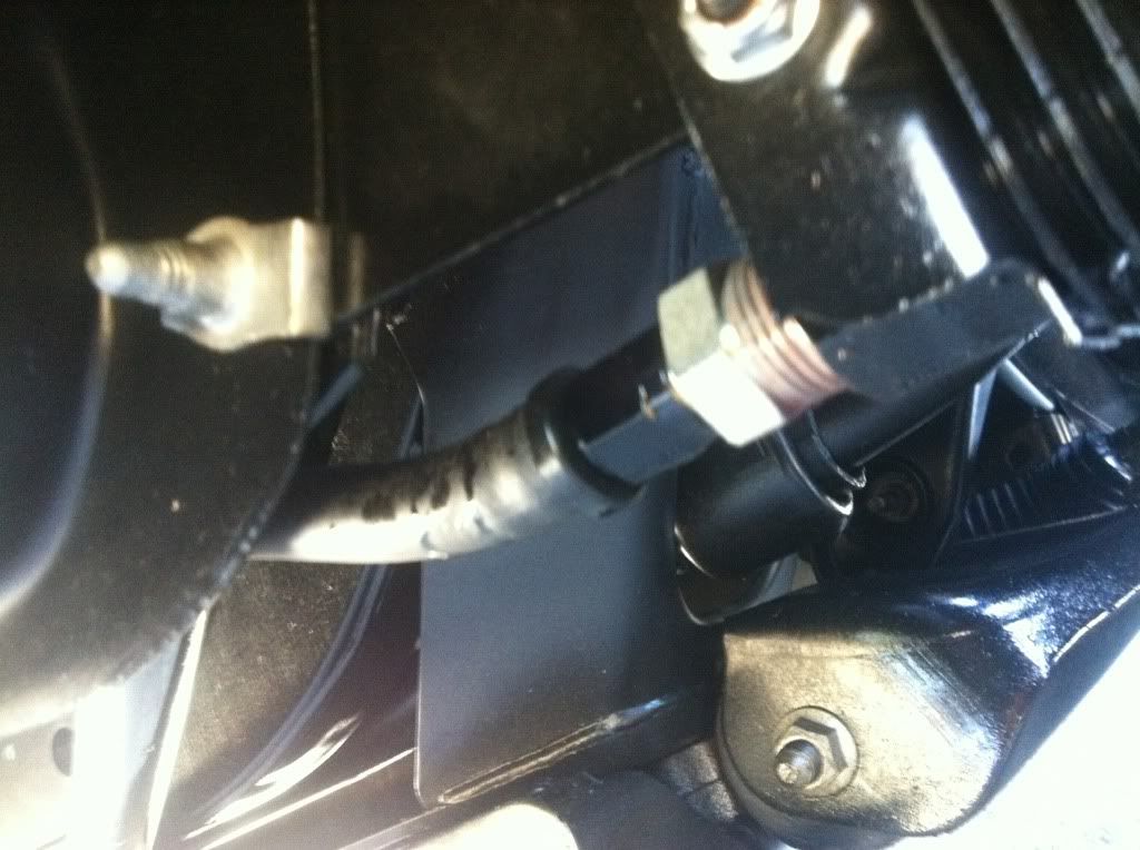

Where the fluid is coming down the line toward the cooler

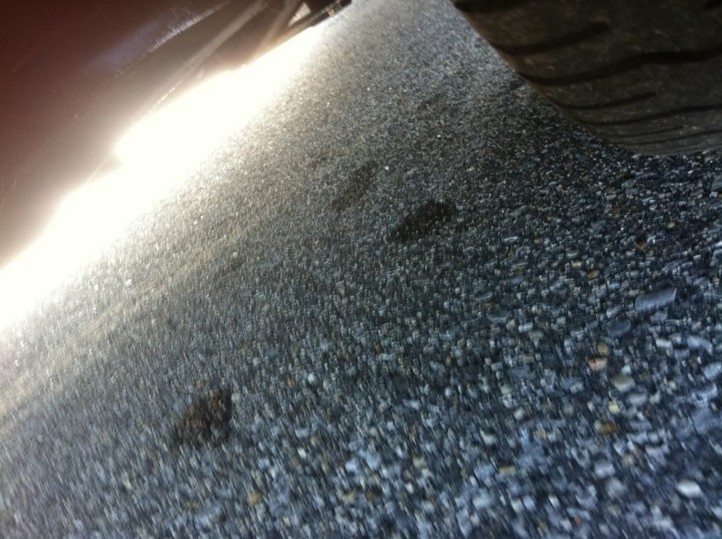

Drops from being at work 7 hrs

Looks like you need to tighten up the fittings.. When i had the trans cooler it seeped out of the top fitting also..

The fitting Next to the fans or the one attached to the cooler? I got under it last night and just can't figure out which line it is bc they all had a little fluid on the outside this morning after I cleaned them up last night.

All of mine had a little leakage at the AN fittings..
Id say just take it all apart and retape the fittings...

I put some hose clamps on each line. Well see how it does.

I put hose clamps on every end and it solved my problem!
