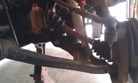

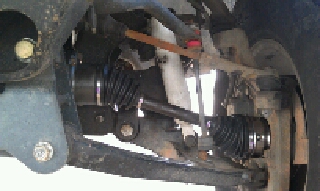

Seems to have worked out. 2010 was a tad longer then the factory with the spacers. I think it will be fine.
OLD
New

You may want to decrank your torsion bars a few threads, that "after" CV angle can be improved a bit and help the lifespan of the axles.
Here is my angle after I decranked mine 7-8 threads. See the before above in post 13, same NNBS axle, just really cranked bars.
