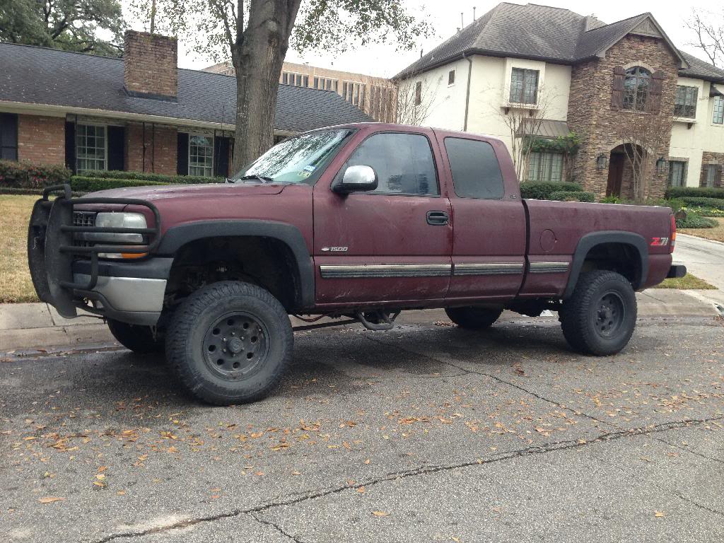

Posted this up on GMFS, thought I would post here for anyone curious about the NNBS axle swap for lifted NBS trucks. Big thanks to sharpshooter for the discovery.
The truck (2000 Silverado Z71 on 33's)

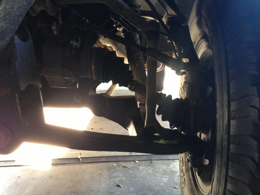

Old axles:

New NNBS axles from Cardone (about $40 each from RockAuto), note the much improved CV angle:

Took about 2.5 hours working slowly but with an impact. Pretty easy swap. I did have to disconnect the bottom of each shock and swing it out to fit the old axles out from in between the shock and sway bar end link.

How Long were your axles lasting with the spacers? that angle was brutal!

tag, mine last 9 months before boots rip in my 04. going to try the part number ya'll posted. maybe it will work for me.
No idea, just bought the truck 2 weeks ago from a friend for cheap. Has 120k miles total, no idea when the lift was put on. But the cvs were totally shot.

Is that just a TB crank TXTahoe, or TB crank and a lift kit?
Fabtech lift kit and looks like a bit of a crank. I need to decrank it, looks a bit extreme.
Need to replace the pitman and idler arms and get it aligned before it's driveable, the alignment is way off.
Decranked it about 7-8 threads, CV angle is much flatter now. Will post pics when I have time.
