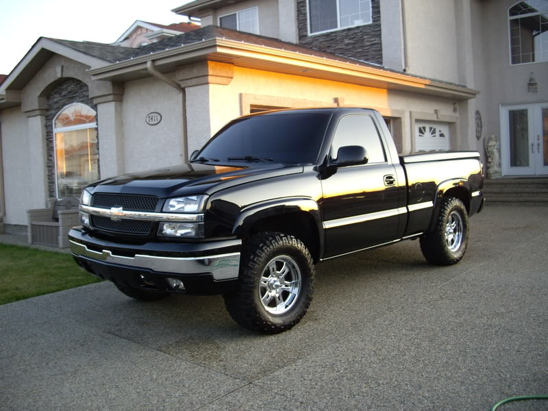

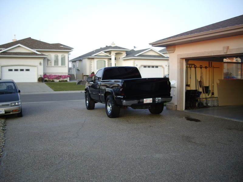

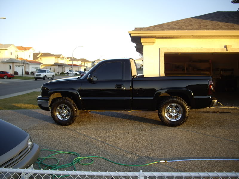

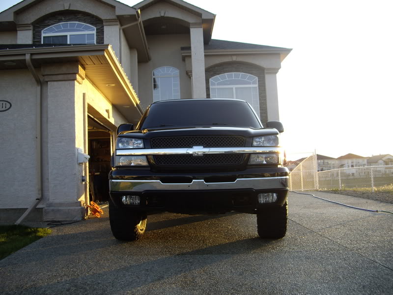

Old Nov 29, 2009 | 05:37 PM
black04's Avatar
iTrader: (15)
Joined: Jan 2008
Posts: 1,406
Likes: 10
From: Phoenix, AZ
Stock keys cranked all the way and iirc i had a drop shackle in the rear. Dont remember if it was set at 1 or 2" at the time. I'm pretty sure it was 1".
Old Nov 29, 2009 | 05:47 PM
sleeperlqx's Avatar
Joined: Nov 2009
Posts: 814
OMG that's beautiful, exactly what I was going for. Im going with some black wheels though. Your trucks is awesome at that stance.
