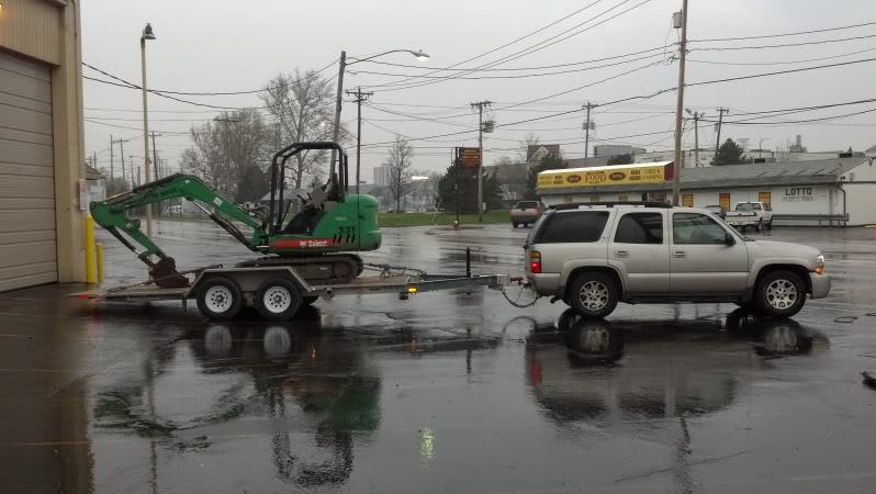

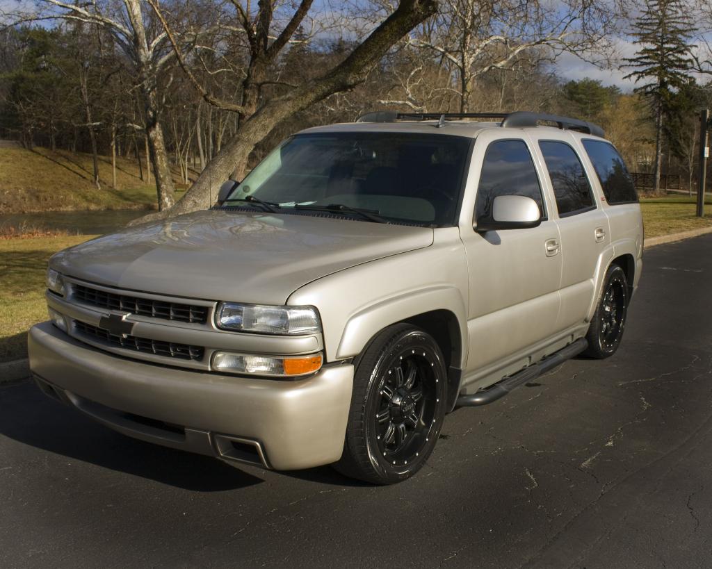

Here is my Tahoe, front is just decranked and the rear bagged. I first installed a level valve so that it was compleatly self sefficiant, worked great but eventualy decided I wanted put valves and a switch on it.
Here she is sitting level with a 28ft camper.
Here she is level with a 12,000+ min ex.

If the camper is really light you might be able to get away with just lowering it and letting the air shocks handle it. They aren't really ment for towing, they are mostly to just keep the truck level with people in the truck.
