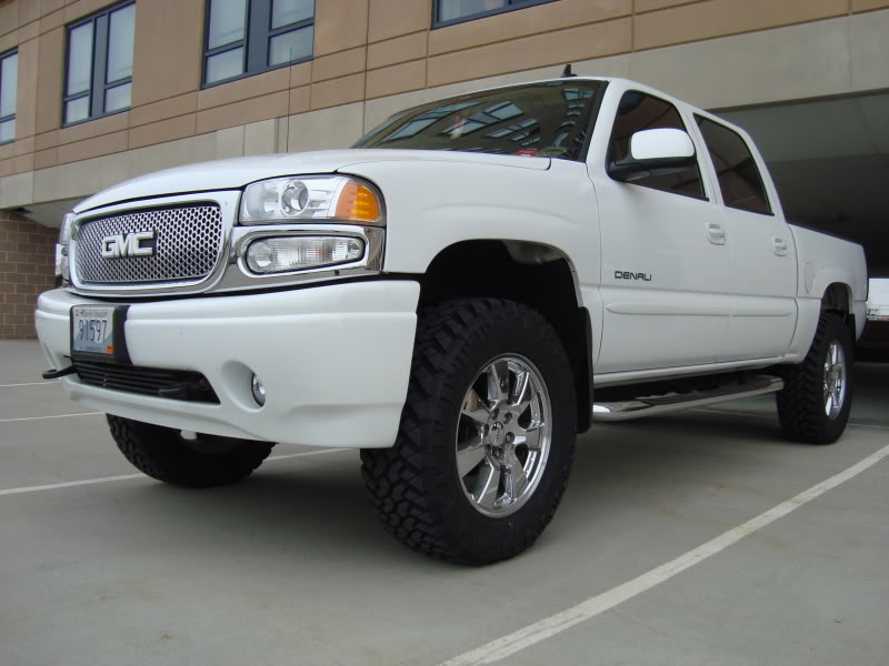

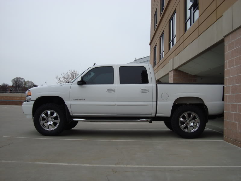

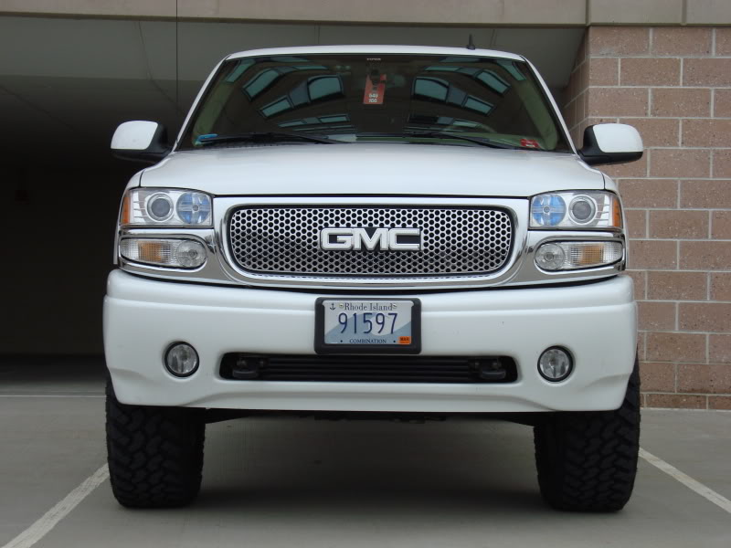

Not sure how I missed this. I was going through the same thing on my truck when i bought it (2006 sierra denali) I first went with leveling keys and aal's out back gained about 2" up front without any bad vibrations. Then i got the itch to go up higher I made my own 2" body lift for $90. So I have 4" of lift and 35's in these pics. Rides like a champ. I am currently about to pull the trigger on a 6" kit and I will make the front shaft work....although I'm pretty sure my truck has the same front shaft as any other 4x4 z71. Deff no cv-like front driveshaft....
