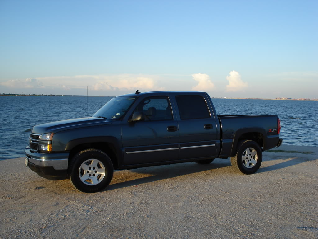

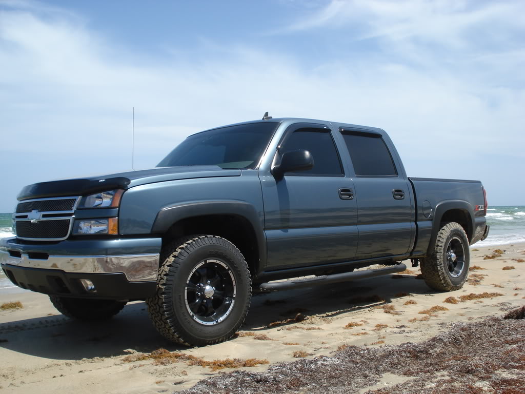

I have about 1" of space between the control arm and the metal stop...When i first had it cranked up it hit the metal stop alot and would make a hellva racket lol so i lowered it back down..
Well here is mine stock
leveled on 265's
leveled on 285's
as it sits now on 255/75's with the ls1 in it which raised the fron up about 1/2 inch lol
