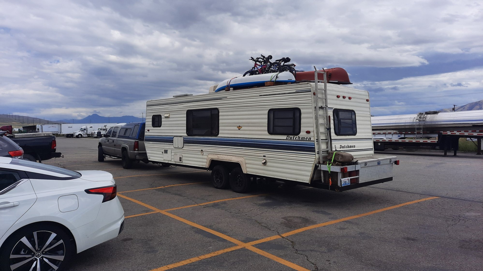

this trailer weighed 7k at one point but is pretty loaded down at the moment.

She looks pretty loaded. Are those aftermarket wheels/tires? That will affect your overall drive ratio.

That wind sail of a trailer must really slow you down. I've pulled 5k to 10k trailers with vehicles or flat stuff through the Idaho mountains fine. I even calculated about 9 to 10 mpg with those loads, but speeds were lower too, mostly 55 - 65 mph.
