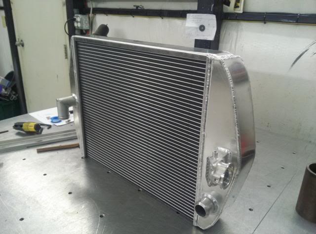

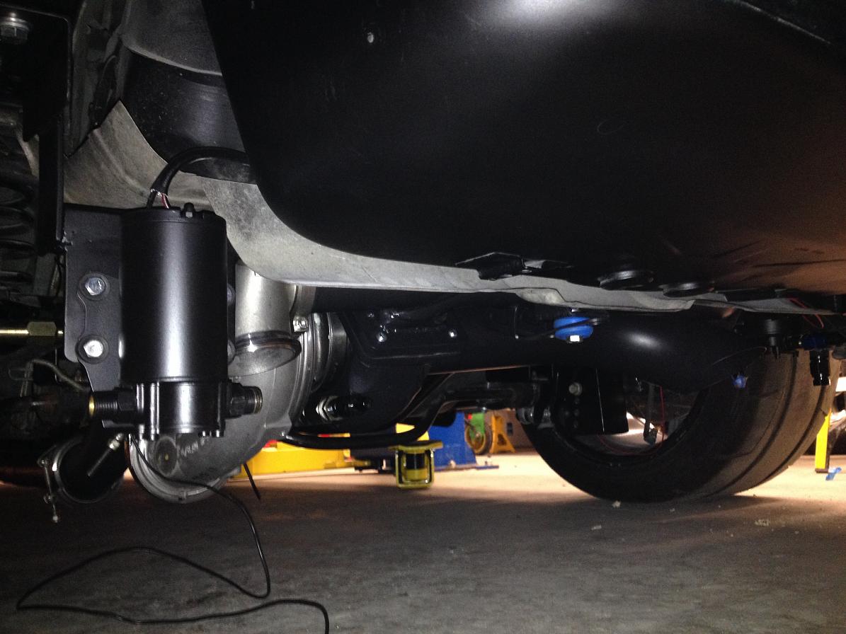

Here's a couple more pics of the giant fab project, made some catch cans and a vent tank, then a dry sump oiling system for turbo not sure if you can see everything. I supported my local ceramic/ powder coat friend well on this set up.

And here is the big picture, the good pic won't upload. Sooo I did a quick vid of the underside.
http://youtu.be/NfSCszCFfXM
5356?
Just an FYI anything that meant to handle any type of heat like coolant tanks or radiators or oil tanks needs to be welded with 4043. 5356 has a tendency to crack when used in higher heat applications.

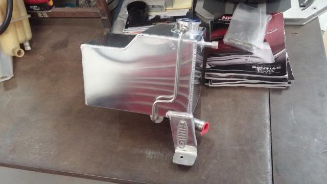

Here is a coolant surge tank we built for the 99-07 trucks.
