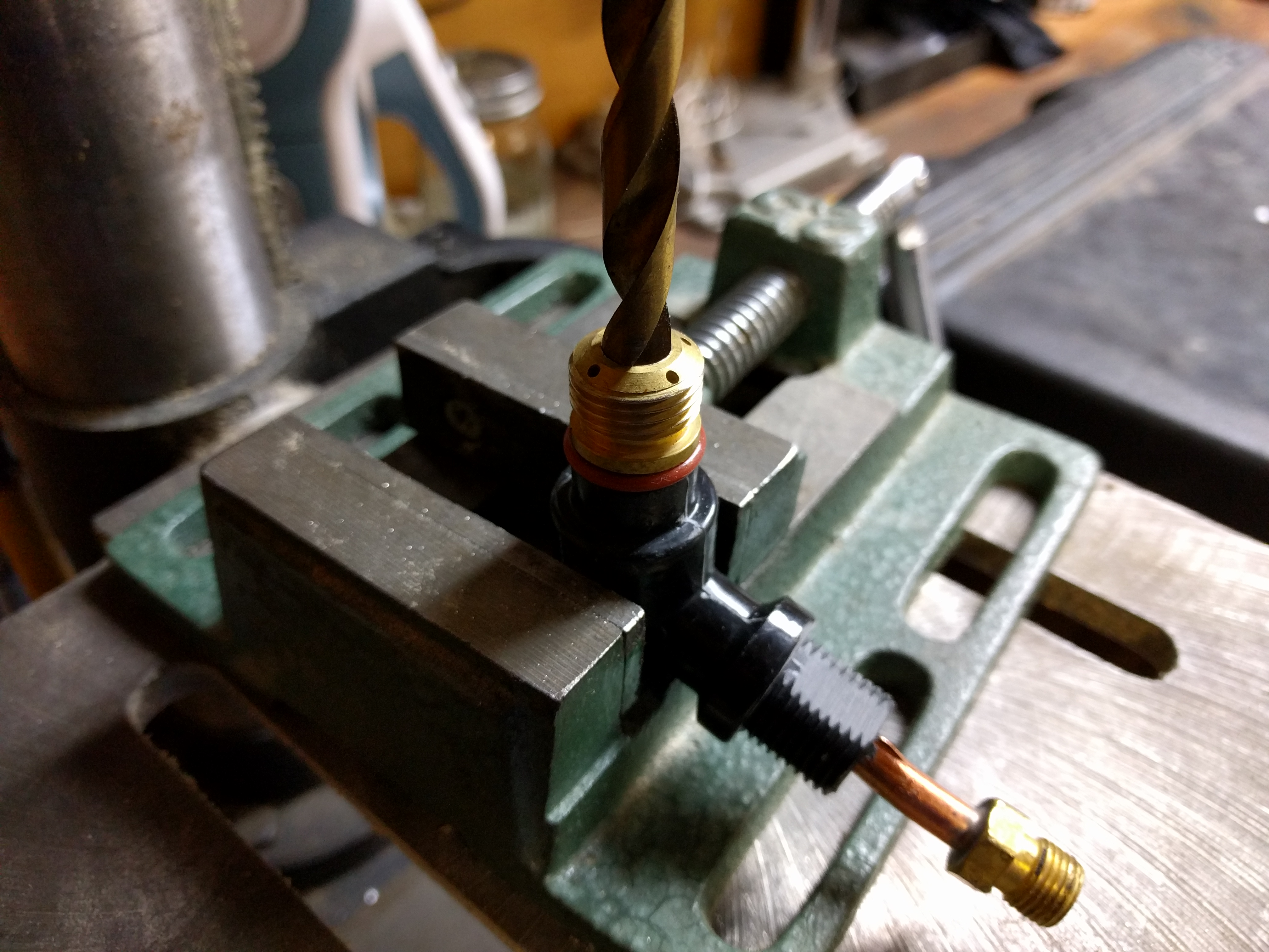

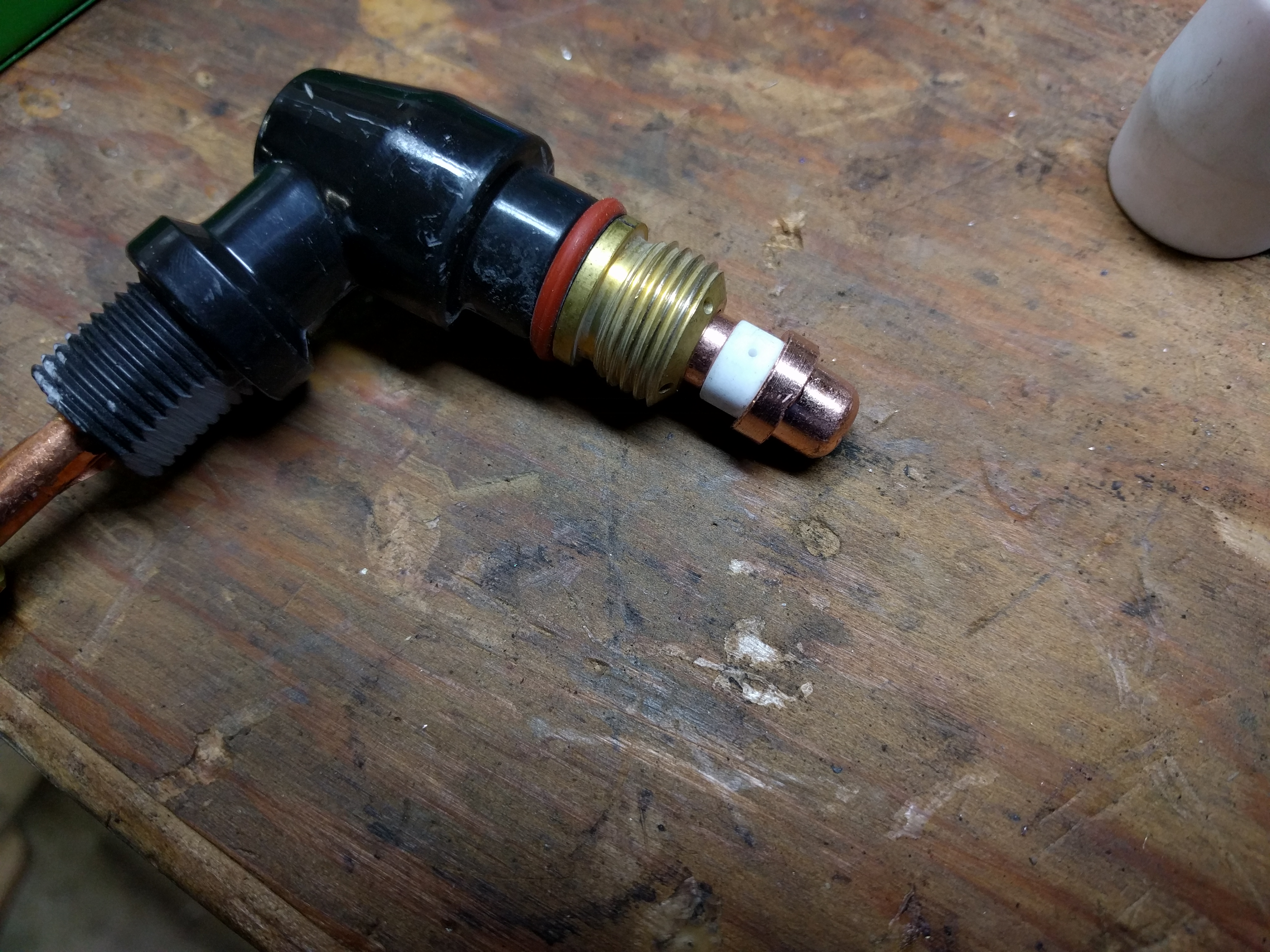

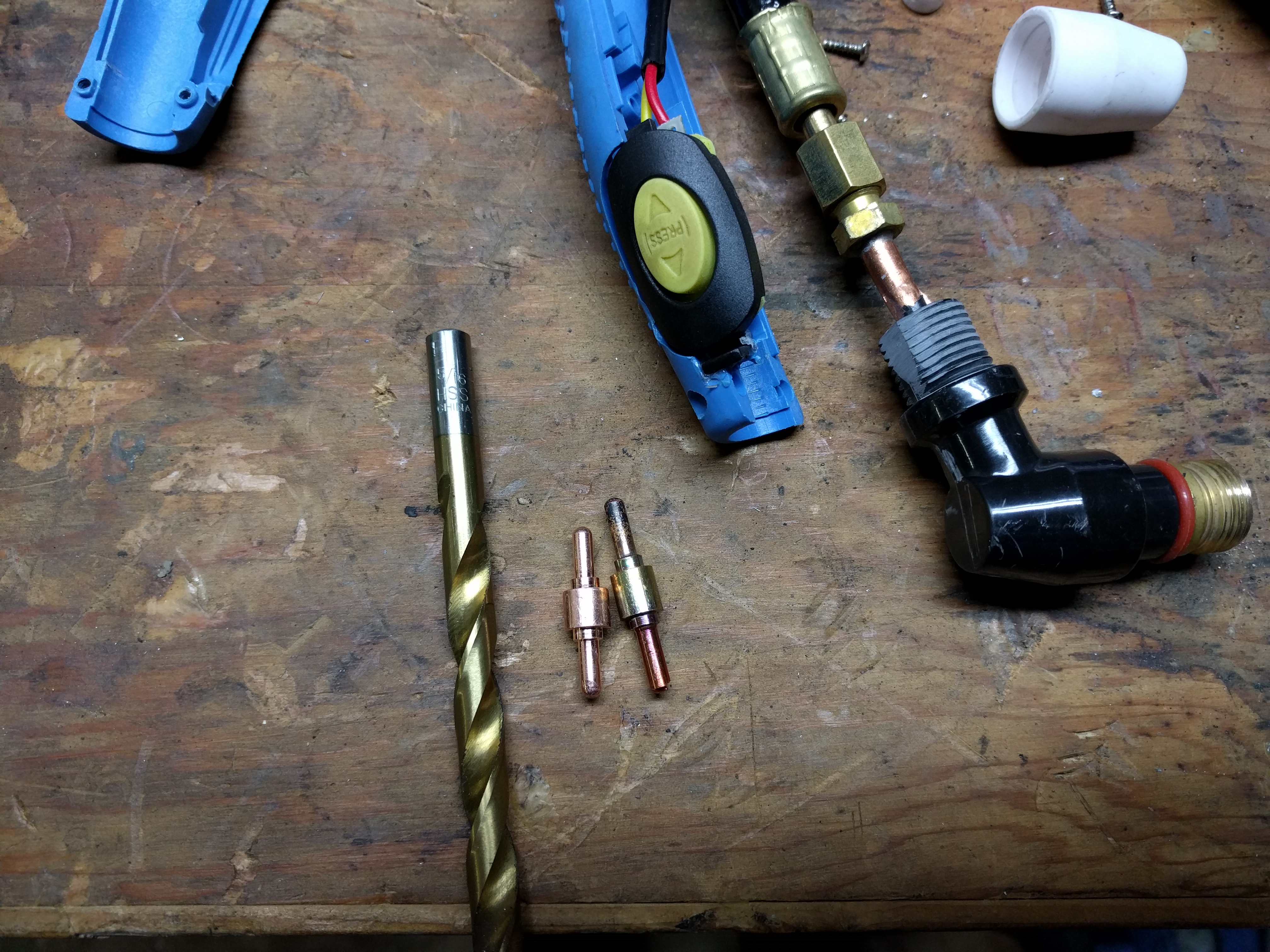

All you need to do is drill out the torch to 5/16", to the existing shelf depth. The LG40 electrodes will then slide right in, and the LG40 caps are slightly shorter which will make the entire assembly fit perfectly. You must use the electrode, tip, swirl ring, and cap from the LG40 assembly.
