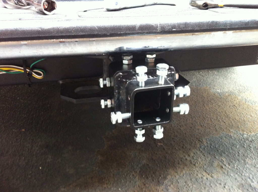

So anyways, Here's what it looks like instealled...

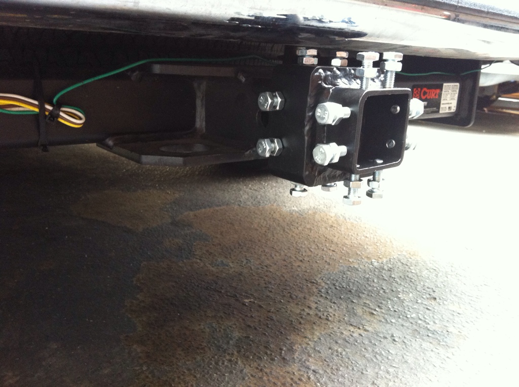

And with the hitch tube installed...

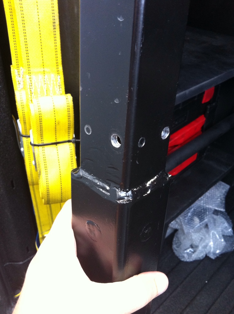

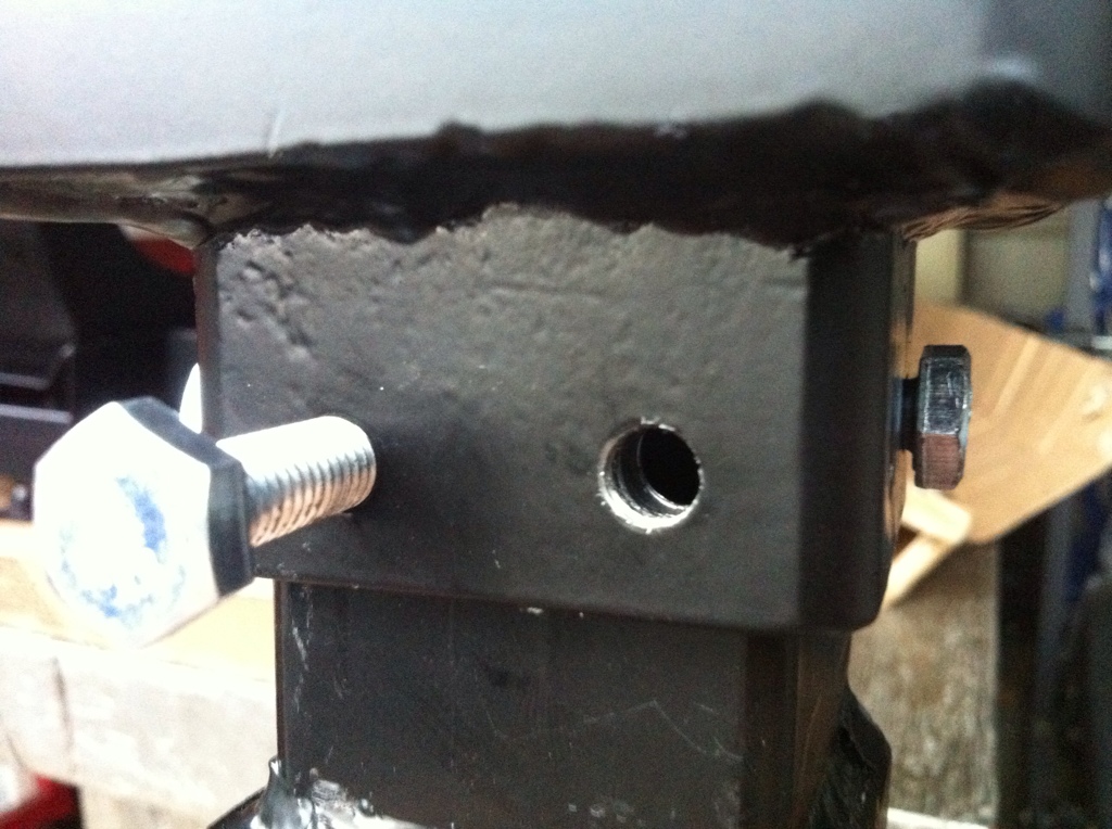

Problem is, it feels cheap to me and I can easily see the bolts walking themselves out without some lockwashers and if I overtighten it I can easily see myself stripping the threads since the thickness of the tube is so thin. So I decided to drill some holes in 4 of the 8 bolt holes in the tube...

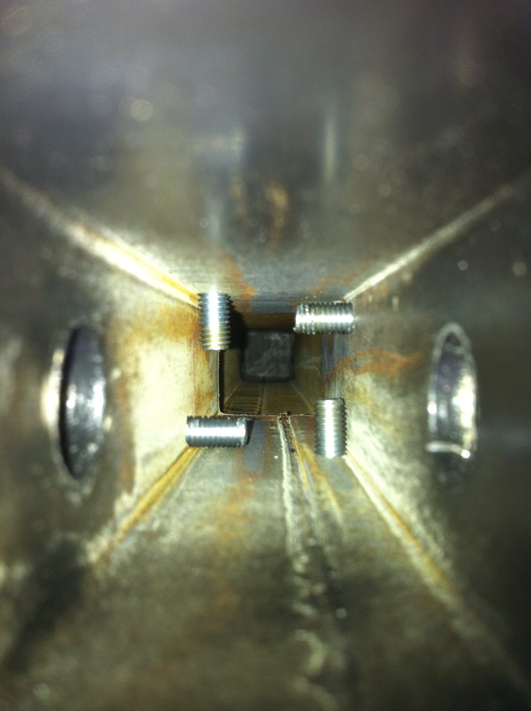

Then I threaded the bolts through into the tube...
So far drilling holes into the reciever tube through the smaller 2" end of the anti-wobble device it seems to do the trick, there is very little wobble with the tube in the reciever now. I kinda want to do the same thing to the bigger 3" end of the anti-wobble device and drill some holes into the reciever hitch but...not sure if that's such a good idea since I use that receiver hitch to tow 10,000-15,000lbs.
Kinda curious as to what some of the metal junkies and frame guys think.

Personally I would do away with the anti wobble device.
Remove the hitch, drill/tap holes 1/2 the distance to from the end to the cross pin (4 holes total, one on each flat) Then weld a nut over each threaded hole. Then use jam nuts on the bolts like you already have.
There will be a quarter of the amount of hardware to keep tight and will be much more discreet.
1/2"-13 grade 8 nuts/bolts would be my hardware of choice.
