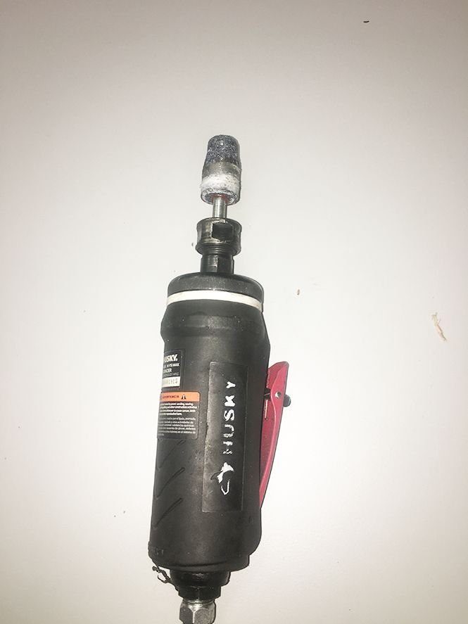

Lastly, you will probably need to clearance the top of the firewall for the hydroboost unit, where the pedal rod slides through. I've read some threads saying guys had to, and others where guys said they didn't have to. On my 2005, I definitely had to. The cleanest method I found was to use my die grinder and a stone:
