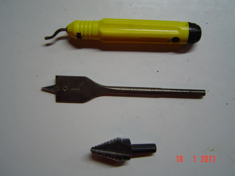

Tools is used:

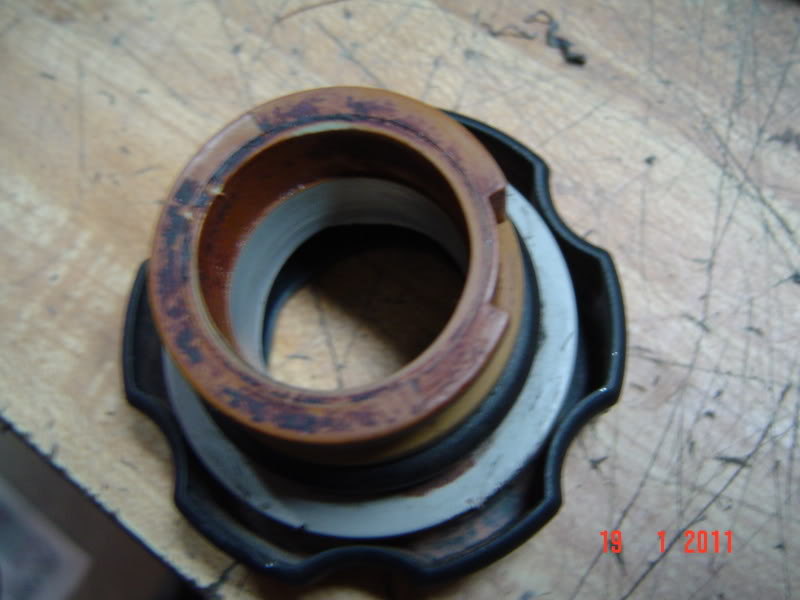

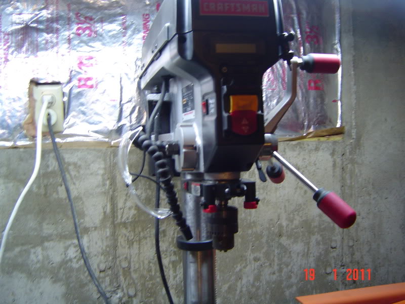

1: take the oil cap you want to make a breather out of and using the 1 inch wood hole bit drill throw the oil cap using the inside to center the bit

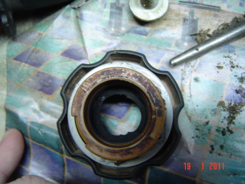

2: from the top side of the oil cap start to enlarging the hole for the grommet until it is 1 1/4 inches across (this doesn’t need to be exact but the closer the better, take your time doing this and test fit the grommet and breather periodically

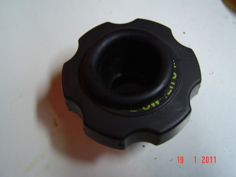

3: after you enlarge the hole in the top of the oil fill cap so you can insert the grommet and then the breather cut a hole in the bottom of the grommet.
4: clean the oil cap and make sure you have all the plastic shavings out of it
5: assemble and enjoy the money you just saved by putting it in your “next upgrade” fund
