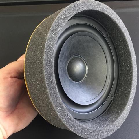

The JBL's actually came with foam to put under them to isolate them.
Pioneer was one of the ones I looked at along with the JVC.
The rings I keep mentioning ARE NOT THOSE and do far more than that.
I've gone over them several times. They go on the front of the speaker to take up the gap between the speaker itself and the opening in the door panel and are a critical component.
They are on all good stereo systems. They are on my current truck (factory).
I keep mentioning and posting links for fast rings, have you looked at the link? I've also mentioned making your own from window seal foam (windows for the house, so it's in the home repair section at walmart or you can get it at home depot.

Yes, I did look at the link.
I purchased some foam from the depot but it's too wide. I have to go back and get some 3/8 What I got is like 3/4 wide.
Its wasnt much money.
The stuff that came with is for Isolation.
Okay cool just making sure you knew what I meant, and once you put it on you'll notice a nice improvement.
You need 3/8 by 1/2" or 3/4" tall. If I remember correctly I used 3/8 by 3/4 and it was perfect. I did the speakers in the rear doors too and it was extremely worth it.
You may have to double stack the tape if you get some that isn't very tall.

Man I was far off. I just found my roll, I used 3/4" wide by 1/2" tall foam and it worked great for me.
1/2" fills the gap between the speaker and the door panel just right. Well it did with mine and the bose door panel setup. You said your speakers mount to the door like the bose do so yours should be the same.. I assume.
