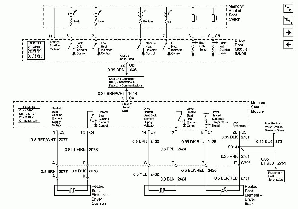

hey guys i just got some power seats off another member on here. i am making a custom wiring harness for them since they are from an 06 and my truck is an 04. the airbag system is different!
ANYways....i need to know which wire require the 12v power off the connector. i know the black one is ground obviouslybut the colors are as follows-

best bet is to go check out a chiltons book at like autozone or something they have the full wiring diagrams in the rear of the book my guess is that the orange would be the 12v but that's just from a radio guy...do you have a test light? just use a test light

Might help.
Attached Thumbnails i need help wireing up my new power seats!-seat-1.gif   i need help wireing up my new power seats!-seat2.gif

Can't paint hoods without a compressor, can't easily wire in new seats without a schematic from the GM service manual on CD..... well on the hard drive now. Loads of info just a click or two away.

thanks guys but its just the orange and black i got the info from another forum!!!
