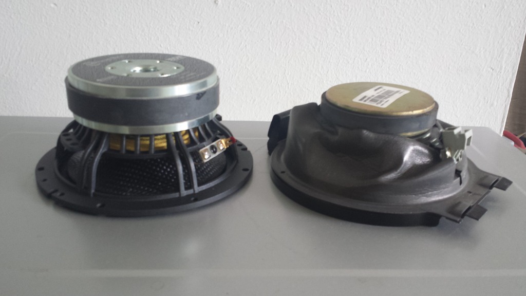

Sad to see how many were hyped about the Bose systems. The sub produces bass, better than nothing, but the door speakers are an absolute joke.
Front door 6.5" Comparison, Bose to American Bass. (Polk dB X-Overs and Massive Audio DT-05 Tweets used for components)
