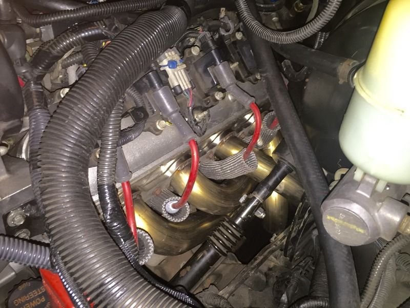

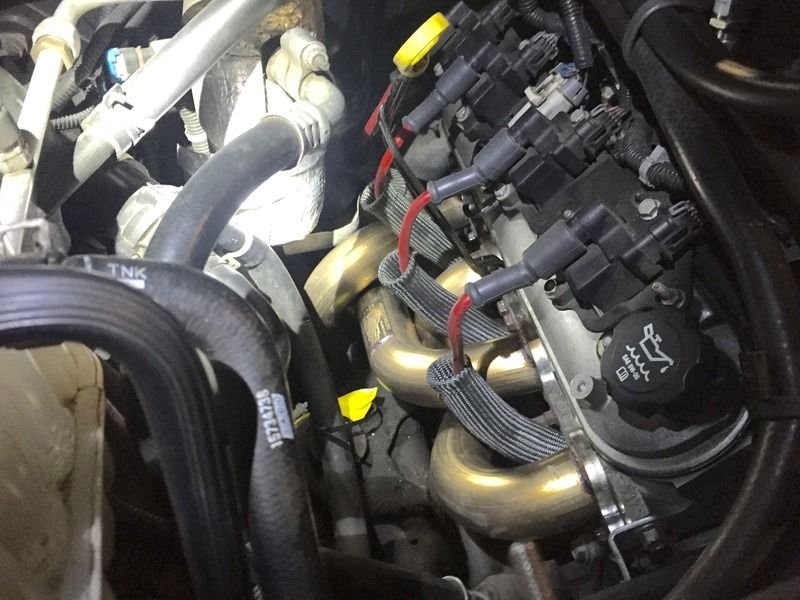

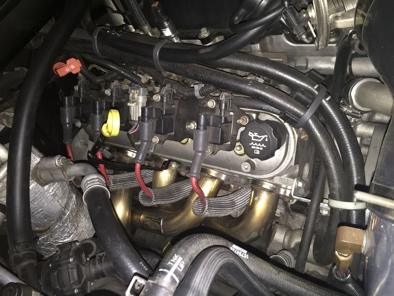

I finally got them on , they fit perfect , and sound amazing just open header .
The quality is top shelf , they do not touch or rub anywhere , they are close to the frame , but have about 3/16" to 1/4" of room. When i get the truck back up on my lift i will take pics from underneath.
On the drivers side , im going to move the brake lines away from them a bit , as where they are run ontop of the frame they are about 1/8" away, i will also put some heat shielding on them, but really , for a pair of 2" primary tube pipes, they fit nicer than the OBX 1-3/4 headers i had , and the plugs are easier to change , seriously .
The hardest part was taking out the ISS ( steering shaft) to put the driver side in , these will not go in from the top , The pass side badically fell into place. I didnt even pull the plugs haha .
Next is underhood cleanup and fab the 3.5" mid pipes .
These things sound great open header
Thankyou ARH for making a high quality large tube header for us truck guys .
Im very happy with the product !
