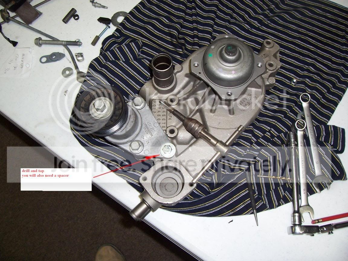

I bought a 97 vette wp/ bolt on pulley and spaced the pulley out about 5/8"
it will also need to be drilled and tapped for the tensioner with a small spacer below it (like shown in pic)
seems simpler than the whole press on press off thing
anyways, here it is for reference

[QUOTE=Kano]I bought a 97 vette wp/ bolt on pulley and spaced the pulley out about 5/8"
Originally Posted by Kano
THANKS, Kevin
