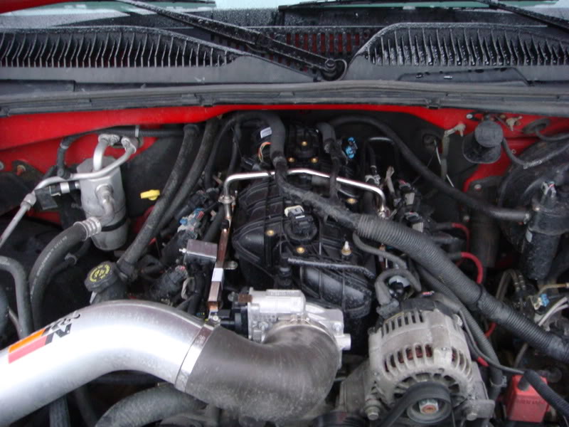

yeah i got a ssr/tbss intake from a member on here with the 90mm tb and holy **** its a different truck. there is alot of low end torque and there is alot of air flow up top. it isnt the prettiest thing to look at but it works. i dont know what it would do on a 4.8. but it is a direct replacement for the stock truck intake. you will have to by a converter for the tb electrical hookup. i got the intake for $400 and then the converter cost me $210. but i didnt have to move anything like when you do a ls6 intake. took me a hour and a half to get the old one off and the new one on. i think im gonna buy a ssr engine cover to dress it up, cuz the stock vortec cover wont work any more. ill get some pics of it and post them up in a few.
i know its drity but i have been drivin the truck all winter and its raining out right now. lol.

the little silver box on the fuel rail is the converter
