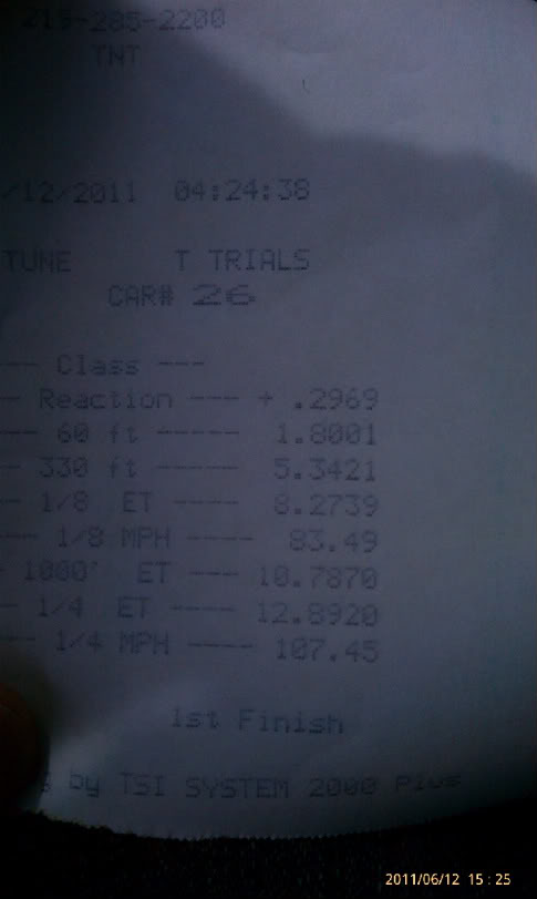

you can get there, just have to get the right setup going. i'm still working on mine. i'm down to little adjustments now.
mods: 6.0 LQ4, t-56 6-speed, 225/229 .585/.585 111lsa, 799 heads milled .030", tbss intake w/tb and dr.x harness, 44lb/hr injectors, lpp long tubes w/ory to a magnaflow catback (3"si/2.5"do), custom driveshaft, 4.88 gears, detroit true trac, caltracs, ta girdle cover w/ bearing cap studs, 16" stock alloy wheels w/m/t et street dr (28" tall), roughly 4600-4800lbs day of race, tuned by me with hpt.
Red04RegencyRST NPB 12.89 @ 107mph - YouTubeName:  IMAG0368-1.jpg

If you want a failsafe setup for a fun, reliable, and fast street truck, follow him ^. My man knows his **** and knows what works. Driving his truck made me want to swap my built/stalled auto out for a T-56. He's an RST O.G.
