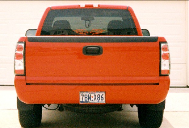

nuff said. I have had mine for over a year. no problems! just be verrrry careful when backing up. you don't want to dent this one

the hitch will go in no problem with the roll pan welded. I have a sir michaels roll pan and a hidden hitch and have had no rpoblems. Depending where your exhaust is will determine how easy your roll pan will come out. Dents are a bitch though. Gotta be extremely careful when backing up and where you park. Also, its very important, especially if you live where it rains or snows that you seal the welds and paint the back side of the roll to prevent corrosion and rust. Other than that, Weld it!
