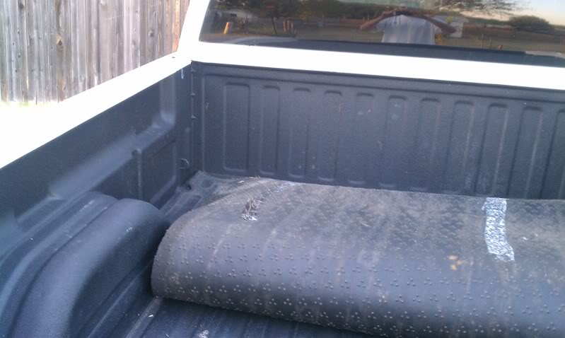

Sorry for the slow delay guys!
Old Aug 13, 2012 | 08:19 PM
WhiteChevy3's Avatar
Joined: Aug 2005
Posts: 612
From: Oklahoma
Old Aug 13, 2012 | 08:20 PM
Joined: Aug 2005
Posts: 612
From: Oklahoma
Old Aug 13, 2012 | 08:26 PM
Joined: Aug 2005
Posts: 612
From: Oklahoma
Sorry its pretty dirty back there. The little discoloration u see is just dirt that has got wet and dried. Also I just recently put the rubber mat thing back in, I had to haul a rearend and other metal parts, it helped keep the Sharp edges from the rear end digging in and **** rattling around.
