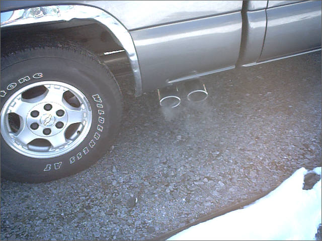

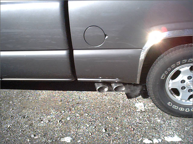

Hi! I'm new here here are some pics of my truck

Looks good, how was that installed? Give us some info.

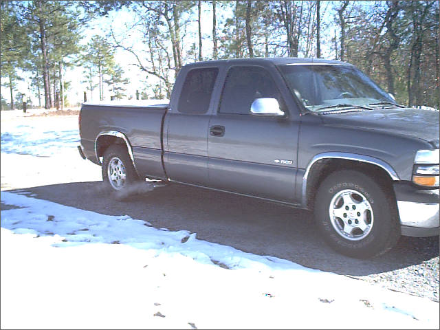

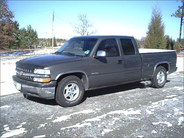

OK, i havent got any sounds clips yet, IM SORRY... I WILL SOON! its been shitty weather and ive been working alot latley, but I got some pics
then here is a couple big pics, ill link these.
Ill take more side shots tomorrow hopefully so you can see. Ill try to do some sound clips.
Pic 1
Pic 2

This is how I did it there's a space between the chasis and the cab right in front of the evap canister. You will have to do some drastic bending to make the left (driver side) around; and over the driveshaft.I use 2 1/2" pipe which give enough room to clear the space with no rattling but you can use 3". The best way is to use a short muffler (14" long) and install it right after the connection in the intermidiate pipe but beware this will put the muffler right under the pass. seat and it will be laugh.I did it myself but any competent exhaust shop may be able to do it.
