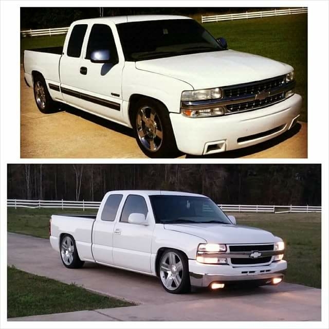

That's exactly how it's done. You'll need the top piece bumper plastic as it swaps over the bumper or the whole HD bumper. Then you'll need to cut the frame horns and drop them about 1.5 inches and weld them back on. Everything is pretty simple
