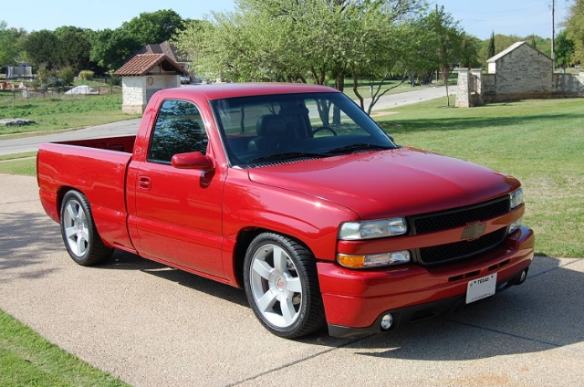

Here's mine.. didn't do the hood though.

Old Feb 9, 2013 | 03:10 PM
  #64
2000chevysilverado's Avatar
Joined: Mar 2009
Posts: 1,579
From: Machinegun Valley KS
That looks good im gonna paint the chrome on mine now
