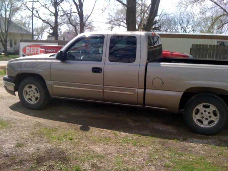

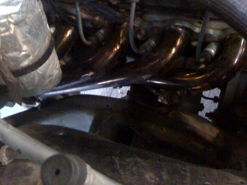

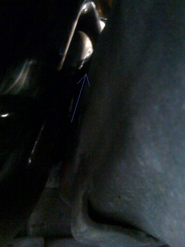

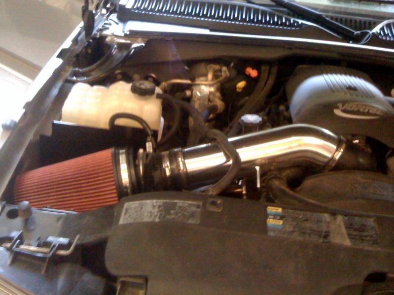

Finally got a decent day outside to take some pics of the new ride and got few mods on the truck plus the wheels im gonna be puting on this week, and one other note on how to fix the rattle from the ebay headers just take a piece of rubber from a radiator hose cut it in half and use a pry bar to push the header over for a second or two too slide the rubber piece in, not recommended if you drive in the city alote would prolly burn up, Ive had these headers on for a month now and never had the rubber piece burn up but i drive highway all the time

header fix pic

Nice truck, Of course I'm a little biased towards it though. lol I'm sure your glad to be back in a full size.

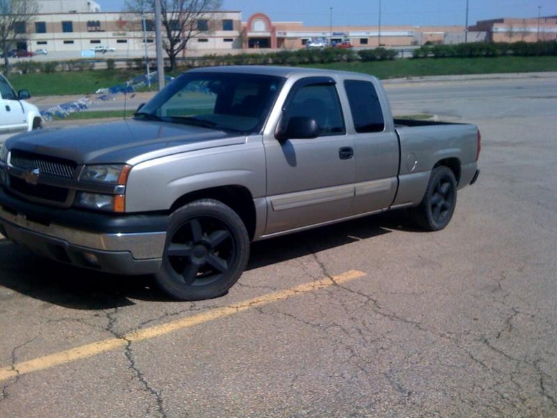

I really want to see the wheels on your truck...
they look good black

i will get my wheel on thursday had to order one cause of the accident in my last full size i will have to paint it but should have them on this thursday

wheels are on
