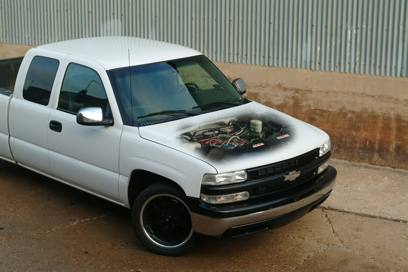

I simply used a rattle can of Krylon Fusion. All I did was wash the lower valance and dry it before painting. No prep work at all!! I'd describe it as a semi gloss finish.....similar to the color and texture of the front bumper cap. Here is a pic of my lower valance shot with Krylon Fusion. It's been about 2 years since I painted it and I don't have any chips or discoloring.

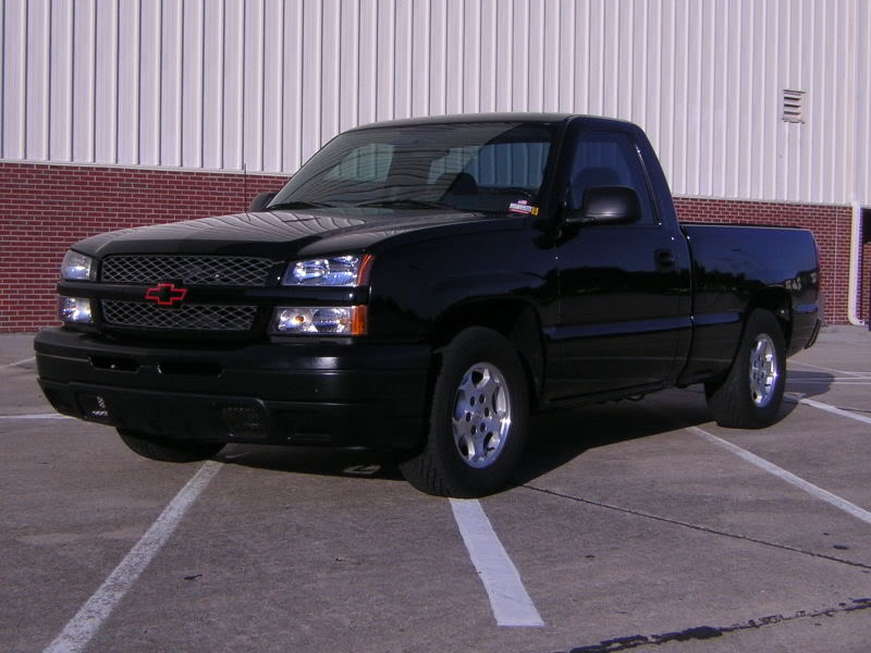

i did my grill, bumper pad and lower valance with a rattle can..did a lot of sanding, filler primer more sanding and painting and clear coat..i sanded the plastic fairly smooth before i started painting
