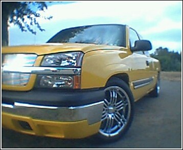

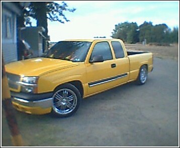

My freinds 04 ECSB Silverado has a 3/5 on 20's from the Dealership
Pics attached
Attached Thumbnails New Truck / Old Questions-21842205189_468.jpg   New Truck / Old Questions-20453753093_468.jpg   New Truck / Old Questions-21842099077_468.jpg
