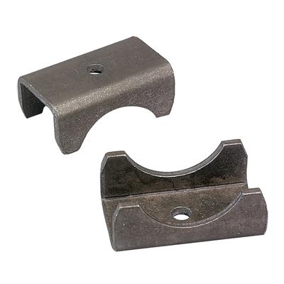

just a poor design IMO. the notch is crap compared to others that i have seen, the bottom piece that lays on the spring is not flat at all, i bent the upper brackets with the bolts and dont think i put too much torque on them at all. im really just not wild aboutt he design and the weight. im guna weld on some new spring perches and drop 20 lbs and get the pinion angle i want and not worry about stuff moving.
i understand what you are saying now. i bent the upper bracket also. just had to realign it a while ago while putting back my street tires on. they had shifted and the pin was off on the hole.

i know you just dropped some good money on it, but you might look into what im doing...its all welded, and factory style so you know it will never shift on you. just put it where it belongs and weld it up. it weighs ALOT less and doesnt include all of the unnecessary crap.
here is a better quality flip kit for 13$
http://www.summitracing.com/parts/SUM-720025/
