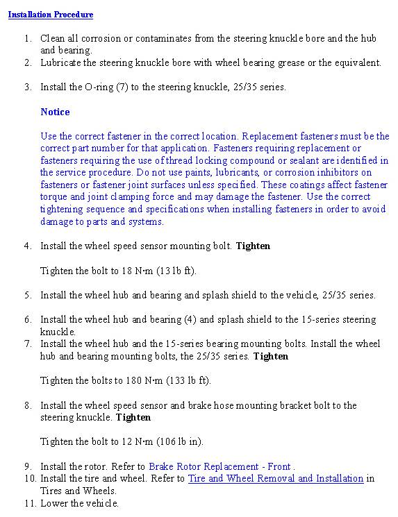

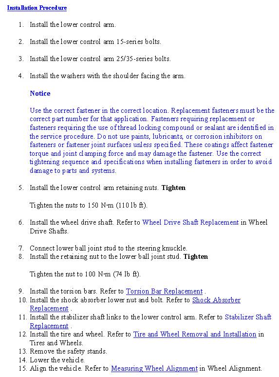

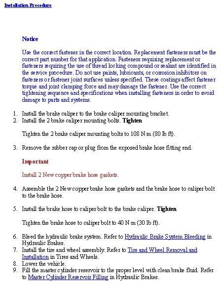

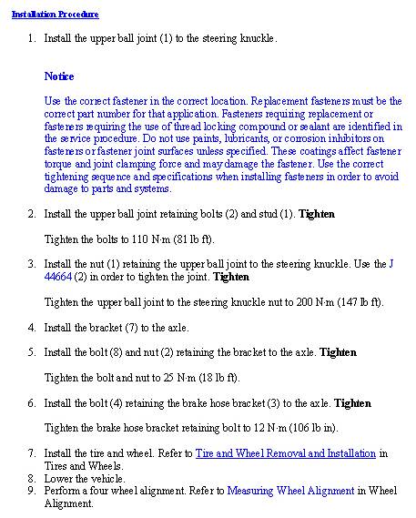

Here is the info I was able to pull for a 2003 Silverado. This is for a 4WD.
Attached Thumbnails Need Quick Help-caliper-bracket-install.jpg   Need Quick Help-brake-caliper-replacement-install.jpg   Need Quick Help-upper-ball-joint-install.jpg   Need Quick Help-hub-4x4-install.jpg   Need Quick Help-lower-ball-joint-4x4-install.jpg

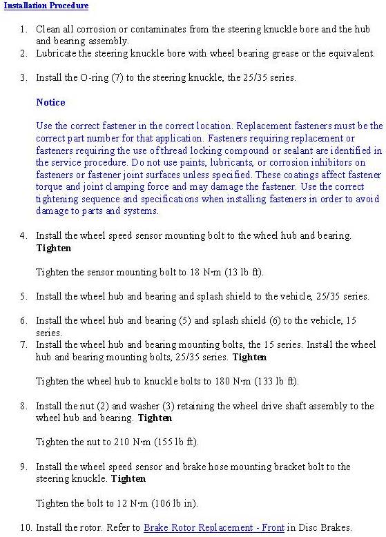

Here are the specs for a 4WD, only the lower ball joint and hub are different between them.
Attached Thumbnails Need Quick Help-lower-ball-joint-4x4-install.jpg   Need Quick Help-hub-4x4-install.jpg

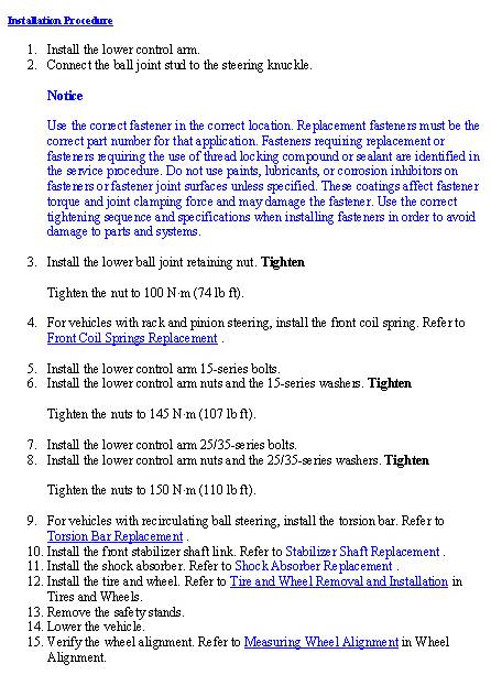

When you said you had torsion bars I also assumed that your truck was 4WD. Here are the specs for a 2WD truck.
Attached Thumbnails Need Quick Help-hub-2wd-install.jpg   Need Quick Help-lower-ball-joint-2wd-install.jpg
