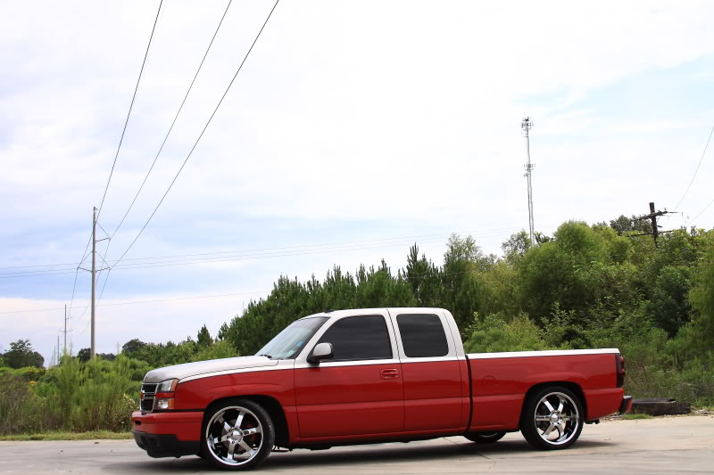

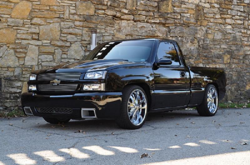

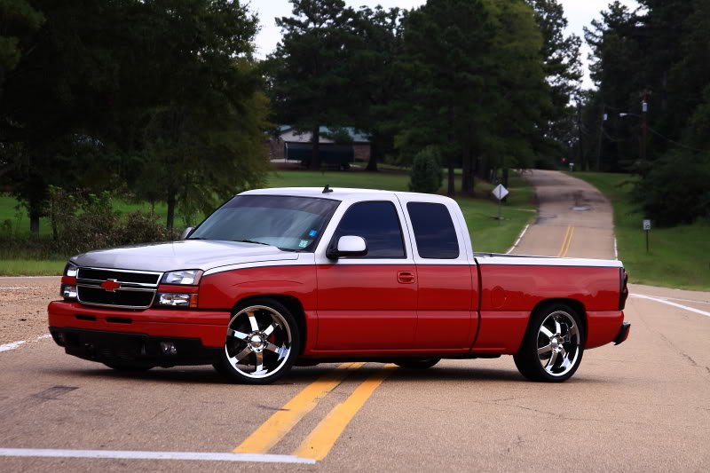

285/35/22 on a 2/4 drop

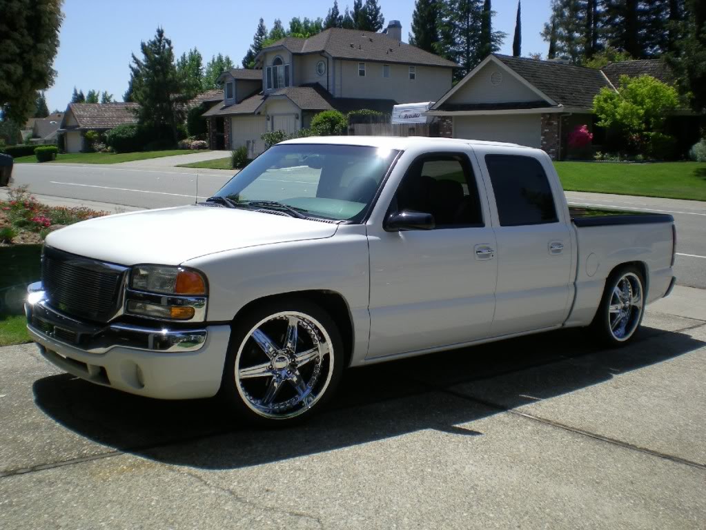

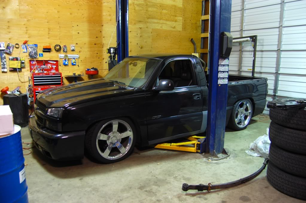

285/35/22 with 5/7 drop.

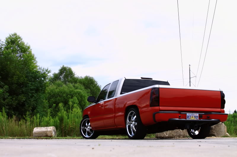

265/35/r22 3/4 drop 300lbs in and i rub the finders

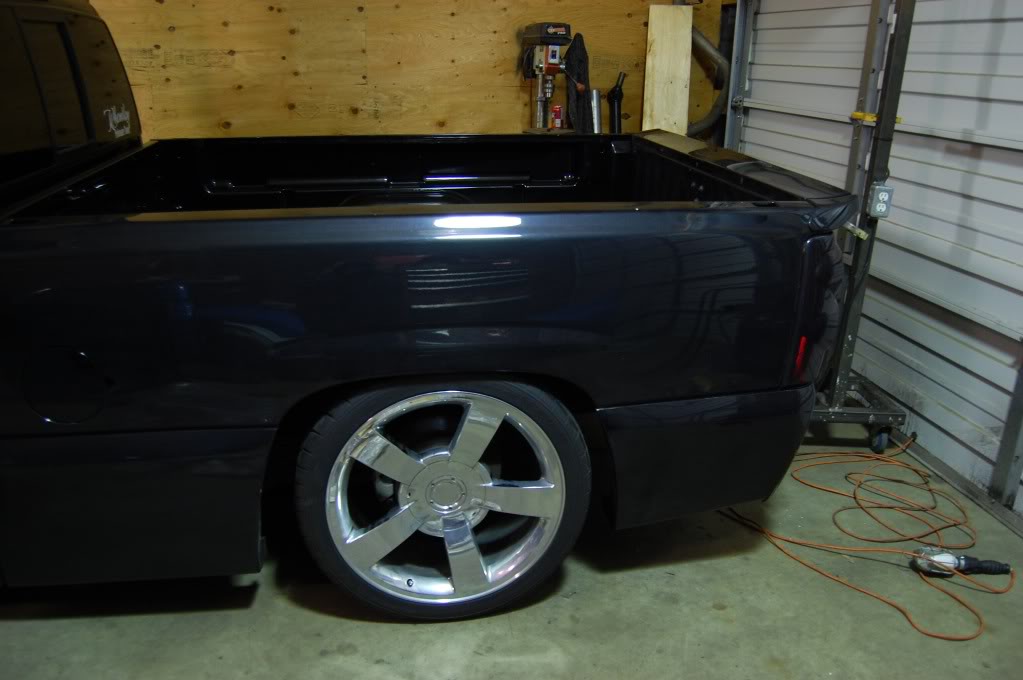

I'm running a 285/35r22 on a 9.5" wide wheel with a 3/6 drop with no problems. The critical number is going to be backspacing of the rim to ensure they don't rub.

How do you figure the backspace? I have 22 rockstars but im not to sure i can lower it 2/4 without hitting the bed...
Old Mar 12, 2011 | 05:44 PM
blue2003ls's Avatar
Joined: Oct 2007
Posts: 496
From: Roseville, CA
On a my 9.5" wide rim the offset was 35 which is about 1.38". I you look at your offset and plug in the right numbers it should be the offset plus half of the rim width and you will also have the front side spacing as well. In my case 1.38"+4.75"=6.13" of backspacing and 3.37" between the rims mounting face to the fender. add a little tire to that and I would say as long as you are 3.4" or less you should be good for clearance.
