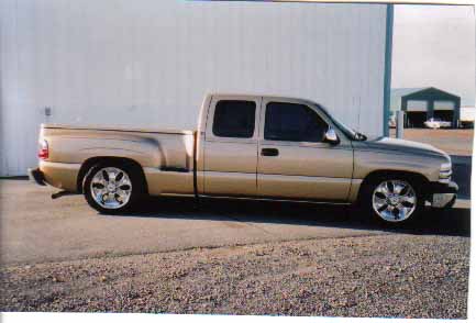

I have 3 inch belltech springs in the front and a flip kit in the rear with air shocks. I can lift it up about 2 inches
