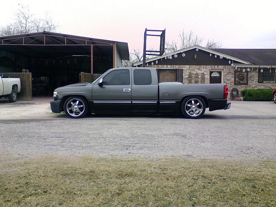

Originally Posted by maxh
yea just do the mini notch in that x member then set your pinion angles. Looks like you got the 2 piece shaft which is good. Any pics of the truck and how it sits?
here it is

Originally Posted by sinistersilverado
here it is
siiiiiq
