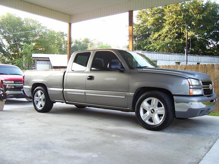

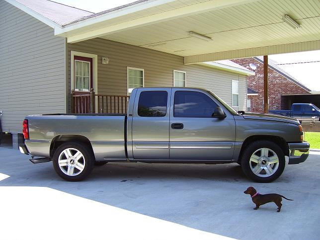

I think a few people were interested in how much the torsion bars would lower the front just by cranking them down. Here is my 06 with the torsion bars all the way down and 2" drop shakles on the rear.

looks real good, would not have guessed that it was cranked down in the front and shackles in the rear. Did you remove the block under the leaf spring pack in the rear too?

no just the shakles

sorry for being a suspension ignorant person, but where is the torsion bar and how do you "crank it down"
i lowered my front about an inch with a heavier engine, but wouldnt mind another inch or two lower.... i did the drop shackles (DJM) in the rear as well.. about 3"
and how is the ride quality? as compared to stock of course..

sorry for being a suspension ignorant person, but where is the torsion bar and how do you "crank it down.........
Not all trucks have the torsion bar set up. It'll be about a 1" diameter bar leaving the front going to the rear. At the end of it will be a 1/2" or so bolt. This 1/2" bolt as you loosen the bolt will lower the truck.
I have not driven it enough to tell yet.
I don't have a block?

Truck looks great, but I have to insert this one comment... if the Dachshund was silver the first picture would be hilarious... am I the only one that finds any humor in that?
I didn't think about it, but yea that would be funny.
