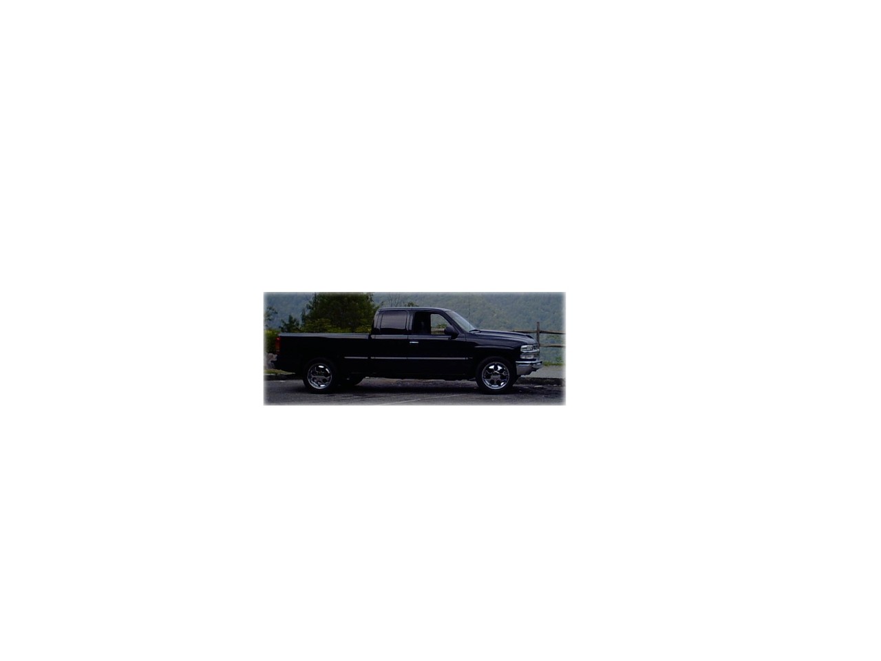

I recently painted my top one, bowtie, and mirror caps. First I used a flex agent and adhesion promoter, then 2 coats of a thick sealer primer, sanded it, two more coats of primer, sanded it, three coats of paint, and three coats of clear. I didn't want to sand the plastic because it can release oils in the plastic that can cause fish eyes. Check out the results.

buy a decent palm sander, dewalt makes a decent one (surprisingly) $49 bucks, and a crap load of sanding pads, 4.5"x4.5" 10 bucks and sand it to death, start off with a 150 grit, then a 220, 320, 400 grit hand sand. It takes maybe an hour of your time and you have to sand the bottom piece anyway, might as well. Then you can sand any of your plastic components easily. Whenever you can break even or spend less money to do it yourself and get usefull tools out of it and some know how, you might as well. more tools makes any guy happy.
