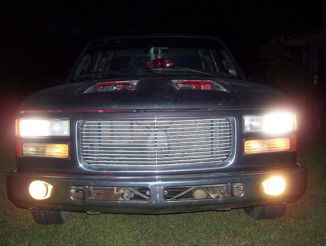

heres my newest project. i am starting on the under side box to mount twin k@n filters in it. the box will mount on the firewall but be close enuff to the ports in the hood to be effective.
Attached Thumbnails home grown ram air-ram-air-002.jpg   home grown ram air-ram-air-003.jpg

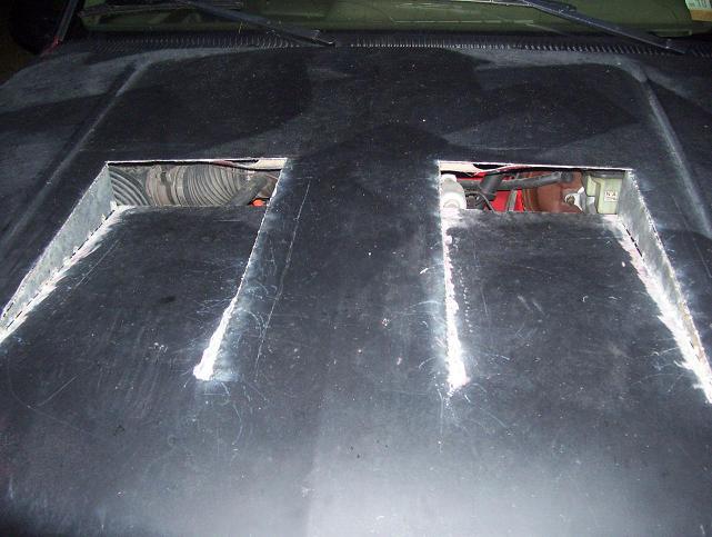

heres one of the under side. i have been bondo ing and sanding today so it looks better than the pics now. as i make progress i'll post more pics. i hope it makes a differance in power.

Are you using flux core wire to weld that?

yes , i need to go rent a bottle so i can get away from it.

I have a little sheet metal fab/welding experience. The flux core will be harder to weld sheet metal. The flux core leaves to much slag on the metal surface to properly stich weld the seems fully without grinding down the surface between each series of spot welds. Are you spacing out all the spot welds?

yes im spacing properly and allowing for cooling.

Well it looks interesting. I'm not sure if it will really be functional or not as in my mind the air flowing over the hood will create more of a vacuum over those holes and possibly pull air out or have no effect instead of pushing air in.
