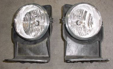

9145 is it...also I think H3 is a translation to 9145. As for the too hot thing, you can open them up and remove that little cap. makes them hella bright. Attached is a picture of them below before install, and before I replaced the bulbs..

how do you open them up and take out the cover? does it really make a difference in brightness?

xacto blade, screw driver, blow dryer, basicaly they are like regular sierra headlights. Pop them apart and then remove the center. Or if you dont want to do that. Cheat, by pushing it out though that little slot above where the light bulb goes in, then break the plastic buble that goes over the bulb and pull it out through the bulb hole.
I used a flat head to push it out then used my needle nose to break it and pull the pieces out.
Some might say they are tooo bright. But they are usualy people in front of me. So **** em. oh and u can just use 9005 lights after you do this since it wont matter after you remove that little piece. You can do what I do and use Xenon Yellow foglights.
