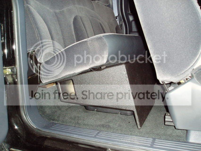

Check out my sig, page 3 for all the details....
They hit really good and are really loud for 10's, I have 1600 watts going to them. I realize you have 12's and they wouldn't fit like I have mine, but just showing you what's out there...

That's a nice box Thunder... What was the port size?

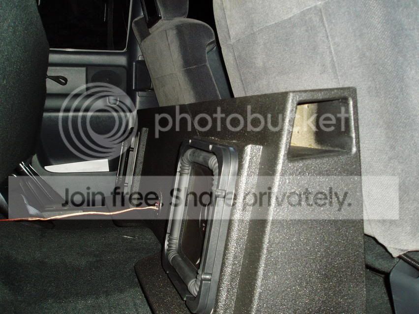

Thanks! Lots of time went into doing it right.
2.5 x 4.5 x 22 or 23, don't remember which. I tuned it to low 30's.

NP man, you desreve props on it. It looks well thought out and constructed. I can see why it hits hard for 2 10s. So you used the floor of the truck as the bottom of the box or did you put a bottom on the box?
You're giving me ideas for my new box in my Ext.Cab since I broke my 2 Eclipse 88series subs.

Nah there is a bottom on the box. Here's a pic of one side before I joined em together. If you decide to build something like this and need any help let me know (as much help as I can give from AZ anyway).
